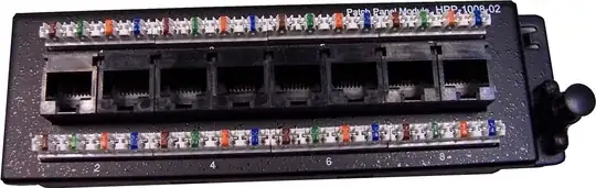

The wires in the walls should be Solid Core. While it is possible to get plugs for this, the normal best-practice is to terminate the solid core wiring on a patch panel, something like this :
And then to run short stranded patch cords into your switch or router.
