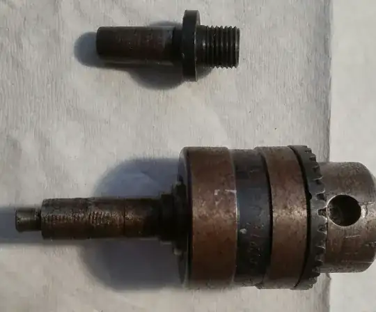

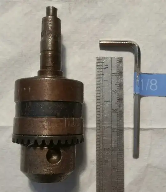

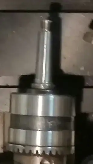

I have an old Jacobs keyed drill chuck in my box-o-spares, and I need a drill chuck for my hobby lathe. I have a suitable tailstock arbour, but the drill chuck has something already installed, and I can't remove it.
The label reads:
JACOBS (r) MULTICRAFT (r) USA
and further around reads
3/8 (10mm) CAP
3/8 24 THD KG

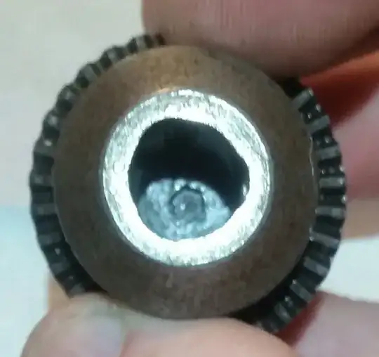

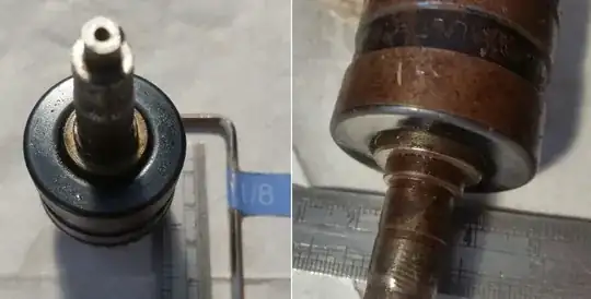

Here's the shot up through the wide-open jaws. Inside is a large-flanged bolt with a shallow 1/8" hex socket. A 3mm tool spins in the hole, and a 3.5mm tool does not fit. Being a metric country, old imperial/SAE/standard/american sizes are less common. I have exactly one allen key that fits. As per photos, I've managed to pretzel the shaft by using a vice and pliers to apply torque in either direction.
  • Is the little bolt going to be conventional right-hand thread or backwards left-hand thread? It doesn't move in either direction so far.
  • Will applying heat damage the chuck? If there's thread-lock, heat may loosen it.
  • Which two areas should I be applying torque between? The old arbour, the outer ring, or the hex tool in the small bolt?
  • Is the old arbour threadded or some kind of taper? The Jacobs chuck references like http://www.michiganpneumatic.com/customer/mipnto/extrahtm/jacobsref.htm and http://www.jacobschuck.com/drill-chuck-removal-guide do not show how this model chuck is mounted.
  • LAST RESORT - should I drill out the little bolt ? No idea what kind of steel its made from, but it didn't distort when I put a 90 degree twist into the allen key, so its likely to be hardened.
I do not need to save the old arbor. There's plenty of apprentice marks on it now from my vice.
I hope to mount it on this morse-taper0:threadded arbour from my Sherline lathe. The largest flange is 16.48mm in diameter on the old arbour and the MT0 from the lathe has 15.90mm
The chuck moves smoothly so I'm happy it will be good. I have not bothered cleaning it yet - unless I can remove the old arbour it will be pointless.
Certainly the usual solution would be to order parts, but given the C19 lockdown, I can't even leave my home, so everything needs to be in-stock already.

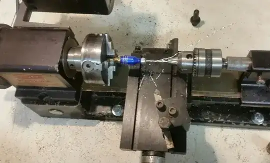

Final update - I managed to machine something close to a MT0 taper into the old arbour. I also cleaned up the surface rust from the outside.

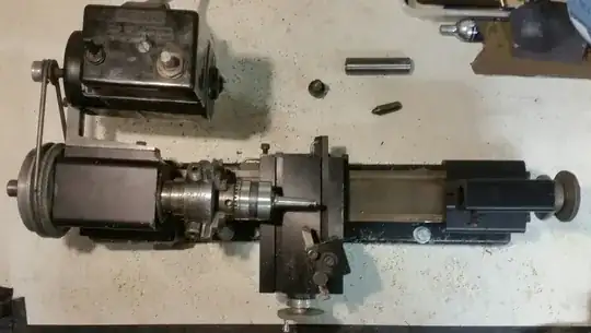

This lathe has a head stock that can rotate for tapers, which was a little sketchy given how much stick-out there was.
This shows the rotated headstock, so the taper is very approximately straight. I didn't have a good solution for calculating the 1.49 degree rotation - will have to do better. Perhaps a really big protractor?
And here's the newly finished drill chuck in use, drilling a hole in the top of a schrader valve cap... for reasons.
Only downsides - 1) its not stunningly accurate, but has already proven way better than "aim and pray" with a hand drill. 2) the tail is quite long, I did not want to remove the center hole on the end, so it only gives 20mm of travel on the tailstock.

I agree with heat if that is a screw but that doesn't look like any screw I have seen on a Jacobs Chuck (and mine were left hand threads) .
Is the model number on the chuck visible? If it has a 3jt or a 4jt it is a Jacobs taper different than Morris taper but to remove will require force. I normally use a mechanics pickle fork for separating ball joints , lock the tail in a vice and a few good wacks and the chuck will come off the tapered shaft if it is tapered or JT3 or 4 . There might be a 2 but I have only worked with 3 & 4.
