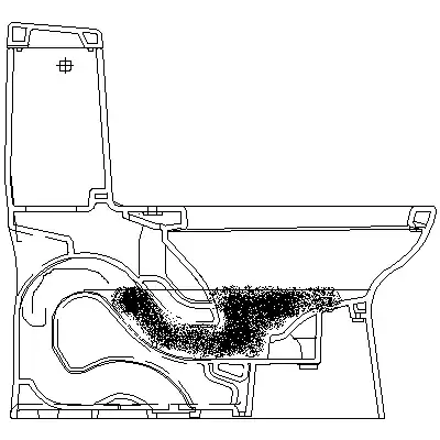

Actually, that's how a toilet is supposed to work.
You can simulate a flush simply by dropping a couple gallons of water in right away.
The spray paint fill is the natural water level. Flushing occurs by suddenly dumping excess water in the bowl. This raises the water level at the back, an a siphon effect comes into play with pulls the remaining water out of the bowl, giving the typical whirlpool effect.
If you're not getting the whirlpool, and a clearing flush, there are two possible scenarios.
  1. The tank isn't full, and not enough water is coming down to clear the bowl
  2. There is a small blockage in the drain.
But timing isn't an issue.

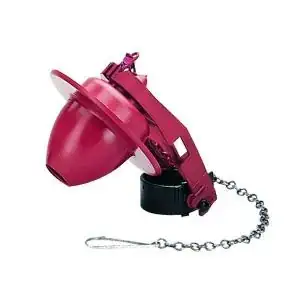

In addition to the tank fill level discussed in Brian White's answer, there is another way to adjust the timing.

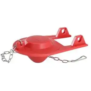

The common flapper has trapped air inside of it. When it is lifted by the chain, it floats in the tank water until the water gets low enough, and then it drops onto the flapper seat and stops the flow.
flapper
Different brands of flappers have different fall rates. I was having the same problem and I changed brands and it was solved.

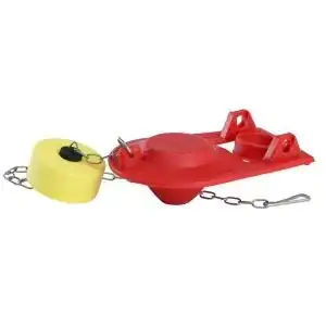

There are also adjustable flappers that lets you change the air volume or add an extra float.
adjustable flapperadjust korky
This changes the timing of the fall and the amount of water in a flush.
There are a few specialized flapper designs, so be sure you check the type in your tank.

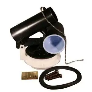

Note that American Standard has a proprietary flapper that has a water filled chamber that hold the flapper open. There is a hole in the chamber that drains and when it is empty, the flapper falls.
am std flapper

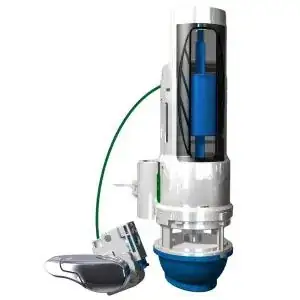

Finally, there are some new systems that let you have a dual flush - you can choose between high volume and low volume.
dual flush
