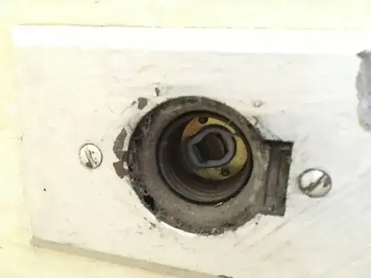

So up in the attic guest room of our century home, there’s a baseboard electrical outlet that looks like a light socket (see picture below). I’m not sure what exactly to call it, and various Google searches don’t turn up anything like it (probably because I don’t know what it’s called). When we moved in, it had one of those screw-in adapters like people screw into actual light sockets; I removed that immediately.
I very much want to replace the outlet with something from this millennium, but I admit to being a little wary. I’ve successfully replaced old two-prong outlets with GFCIs before, but I’m not sure if this is likely to be significantly different. I do expect 15A knob-and-tube wiring, and I’m not expecting a ground wire, but I’m wondering if there’s anything else I should be ready for before I start in. Or if this is one of those “oh crap, dude, don’t go anywhere near that thing without a certified electrician with thirty years of experience!” situations.

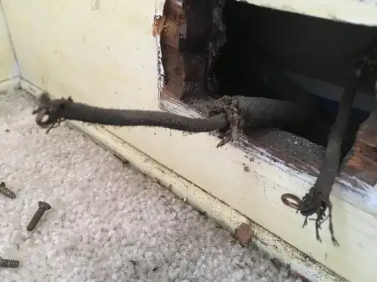

EDITED TO FOLLOW UP: here are some pictures of the wiring and units. First, the wiring after I disconnected the receptacle and unstrung the leads from the gang box.

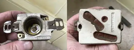

The gang box itself is solid metal, stamped “STEEL CITY” in the back. The receptacle unit’s body appears to be porcelain, both in look and feel and because it chipped pretty easily when my screwdriver bit slipped off a screw. Here are the front and back.
The manufacturer appears to have been Bryant, as per the stamp on the upper left corner and also the fancy engraving on the contact tongue in the back of the socket itself. If I’m not mistaken, that lower right corner is stamped “660W250V”.

This appears to be an ancient Edison-screw-receptacle
What you have appears to be an ancient sort of receptacle, from the days when people put Edison screw bases on the end of cords because standard NEMA receptacles weren't a thing yet. I'd put a new single-gang old work box in there with the correct tubing/bushings for that old K&T wiring, and then fit a 15A GFCI receptacle at that location; just be careful to make sure you don't get hot and neutral mixed up!
