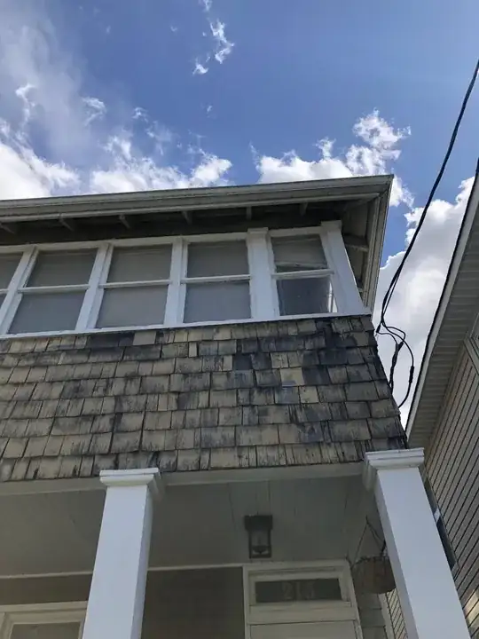

I am trying to get an extension ladder in position so I can finally clean these gutters. I have a stabilizer, but it's narrower than the span of 2 windows, and I'm very uncomfortable putting the ladder up this high without it. I'm having a real whale of a time getting the ladder into position. I'm thinking that somehow I need to get the stabilizer legs above the windows, but still beneath the gutter line. I'm hoping that someone has tips or tricks for getting this ladder into place. I know the wood shingles on the front need replaced-- that's next.
I contemplated putting the stabilizer beneath the windows, ie not on the highest rung, but I wasn't sure if this was safe or not.
It's a 28' Werner fiberglass extension ladder, and Werner stabilizer.
Any suggestions?
The area of interest where I am finding difficulty placing a ladder.

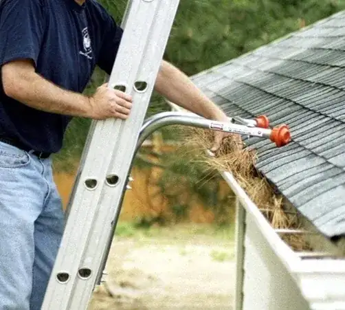

You need a safer stabilizer, one that goes on the roof.
I wholeheartedly recommend the Ladder-Max Ladder Standoff Stabilizer. I know it's a bit pricey but it was worth every cent to me. It doesn't damage my gutters nor shingles and I feel totally stable 28 feet in the air while cleaning my gutters.
I highly advise against resting your ladder on the gutters especially if your gutters are a thin gauge aluminum. Even thick gauge aluminum will sag over time with repeated abuse. Replacing gutters is a heck of a lot more expensive than buying the proper equipment for your task.
I think there are competitors which sell something similar for a slightly lower price.
You can try to achieve the same result with your Werner but you may damage the roof and it might not be as stable.

Do not rest the ladder on the windows (or elsewhere) on the wall: you need to get above the gutter. I'm not 100% sure what a Werner stabilizer is, but if it is what we in the UK call a stand-off, put it on the second or third rung from the top so there is some ladder above it, and rest the stand-off on the first row of roof tiles. That way you can get your arms just above the gutter and still have something to hold on to, and won't damage the gutter. Of course, it the Werner is something else, a stand-off is what you need! By resting on the roof, it will prevent the ladder falling sideways, but you should still secure the bottom to stop it slipping out, e.g. by strapping it to a screw eye in the house wall, or banging a spike into the ground to fasten it to etc. I also recommend a body harness and fall arrester as a slip could be fatal -- and it happens! Make sure your ladder is tall enough to reach and still give 73 degree angle.
