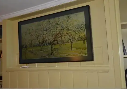

It may not be desired, but sometimes it's the only available wall space in the room. FYI, we mounted our 55" above the fireplace. But the fireplace was converted to propane at the same time. I was able to attach it to some paneling that was used to build the fireplace surround, after appropriate reinforcing.
Here's a picture of it completed. Note that we have not had a problem with the viewing angle.
EDIT 1
I'm sure having the set recessed helps with the heat. Samsung had all sorts of info in the mounting instructions as to when being above a fireplace would be an issue.
No, I haven't noticed much heat, if any, at the surface of the TV.
EDIT 2 - Answered question from Criggie
The two small panels on either side of the TV were the heatilator (?) outputs. Fireplace itself is steel/iron plate. So there's a cavity between the steel and the brick. Intake vent on the bottom and exhaust at the top on both sides. Strictly convection, no forced air (fan), so never got much heat out. The one on the right hides the shutoff valve for the propane log insert. The one on the left I used to route the FO cable from the box (which is on one of the shelves just to the left) to the TV.
The flat panel TV doesn't put out much heat at all, as all the processing and intelligence is in the (hidden) box.
