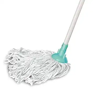

Use a floor mop, the bigger the betterFloor mop
Push hard down so that you get downward water pressure.
Eventually it unclogs anything and everything!
Best trick ever!
