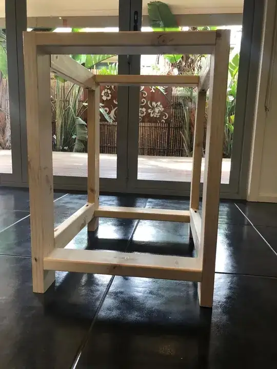

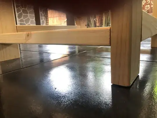

enter image description hereI have started to build a farmhouse table and now facing an issue in the build. The Storage Area i have built is rocking and i believe one of the legs as shown in the attached picture is a slight 1 - 2 mm above the ground and guess this is causing the wobble.
Any Suggestions on how do i rectify this and improve the build as I am new woodworker and this is my first project.

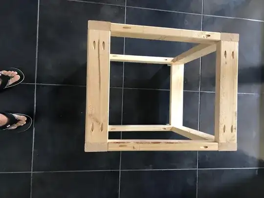

Note : I have glued the Aprons that connect my two legs and i found the wobble only after that and i am using pocket holes for jointery.

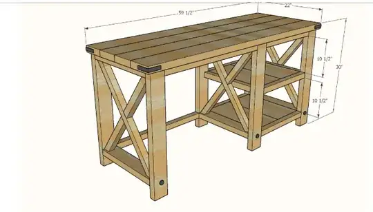

Please find the plan and my build images as shown in the picture below. 1. Plan of My Desk 2. Image of the Leg which is slightly higher from the ground 3. Straight View of the storage area 4. Top View of the storage area Desk Plan[![][1]]3

How do I rectify this? This is my first project.
That's an easy, inexpensive and useful first project.
Even if the work is square and accurately cut, it's easy to be off by a couple millimeters. And even if you're not, it's easy for the floor to be off a couple millimeters; tile is not perfect.
Your best bet is to do a web search for furniture leveling screws. You screw them into the feet, and by adjusting the depth of each one individually you can dial it right in to not just remove the wobble, but also get the work surface exactly level in both directions. They'll be fifty cents or a dollar each, or thereabouts.
Eric Lippert
  • 1,310
Glue a piece of packing to the short leg. or cut the other three legs to match.
Make sure that the floor surface is level as a small difference could also cause the issue you face and if it is the cause I would go with my first option.
Solar Mike
  • 30,038
  • 69
Congrats on a new addiction!
First, for leveling the table I'd suggest a belt sander on the long legs, just make sure you measure and mark where the sanding should stop. You can try to cut them down with a circular saw, but the cuts are probably going to be inaccurate. You can increase the accuracy of the cut by holding a framing square to use as a guide for the saw. If your floor isn't quite level, then you can use felt pads doubled up on the short ones to help take care of it (and preserve your floor).
Just another note, although pocket-hole screws look pretty good in this situation, the shear strength of pocket hole screws is dismal at best. You want to make sure that nobody (even children) stand on the lower parts of the table. Ideally you'd sink something with higher shear strength through the whole adjoining board. You can counter-sink the holes larger and then fill them in with plugs to make it look really good. Also invest in a Japanese pull saw (they aren't that expensive) so that when you fill the plugs, either in pocket-holes or dowels, you can cut them flush.
Another tip, if you want to make 2x4's look "furniture quality", pick one without knots then cut each long edge on a table saw to take off the round-over, usually 1/8" or so will take it off.
