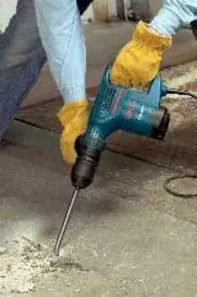

I think that you will end up chiseling and chipping, rather than drilling. I would be very difficult to hold a tool by hand and drill a hole that size into hard wood.
I would consider renting (or buying) a chipping hammer and use a chisel bit:

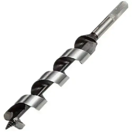

An auger bit would work very well for this situation. It has a threaded tip so it self drives and no downward force is needed, just insert and go. Also, it won't spin in the chuck under high stress, the end that inserts into the drill is hex instead of round. They come in some pretty large sizes. Be careful because the self driving feature also means that the bit is in constant drive mode and therefore, unlike regular bits, there is always a torque on the drill and the only way to stop that is to let go of the drill trigger (stop drilling). If you use a 'hole hawg' or other larger and VERY POWERFUL drill it is very possible to break a wrist.
