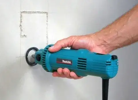

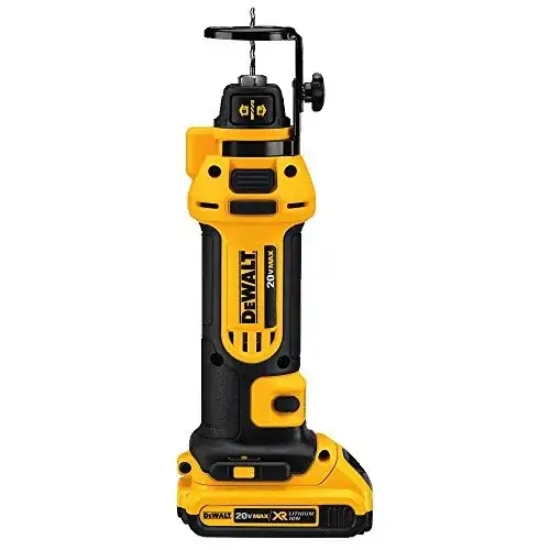

This is a hack thou, and if you are doing this often enough, there is a much better way which is a dedicated drywall cutout tool
