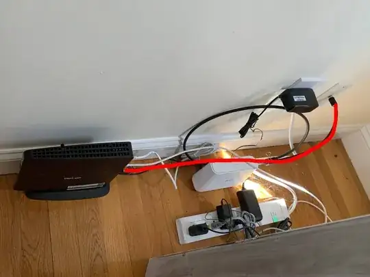

Router: enter image description here

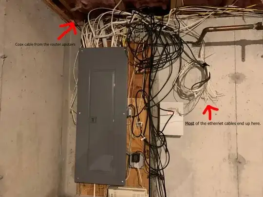

Network "area": enter image description here

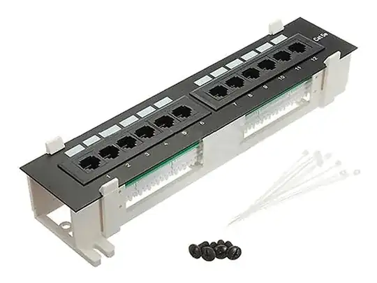

  3. Buy a patch panel, and terminate all those ethernet cables into it. This will give you a line of sockets on your basement wall.

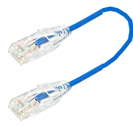

  5. Connect the switch/router-lan ports to your patch panel with short patch cables. These are ethernet leads from 30cm to about a metre. You don't want long ones because of added clutter

A Patch panel to mount on your wall, this one has 12 ports. You can use several, or some patch panels have 16/24/48/96 ports. Comes down to cost. Some patch panels are designed for rack mounting - you don't really need this. enter image description here

Patch cables - these go from your router/switch to the Patch Panel. They should be relatively short for tidiness. I personally like the thinner ones like this. Functionally these are the same as flyleads from the wall-jack to your computer/printer/device just lengths that differ. You can use colour-coding at the patch panel too - red is important, blue is POE, white is desktops, etc. Patch cables are cheap but you need one per active link. Have a couple spares too.

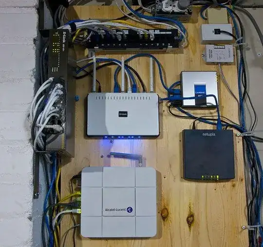

This is not my work - but demonstrates what your basement might look like afterward. Left is a 16 port dlink switch for more ports. Bottom is an alcatel router, maybe internet. The Netopia thing I don't recognise, the Linksys is an ATA for telephony. The three-aerial dlink in the middle might be an access point, not sure why two ethernet patches. Up top is a patch panel, and some misc cable terminations on the upper right.
Its not perfect, but its secure and functional, and accessible for changes. If you want ideas check out https://www.reddit.com/r/homelab/ and https://www.reddit.com/r/cableporn/
