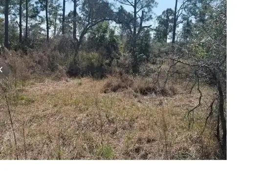

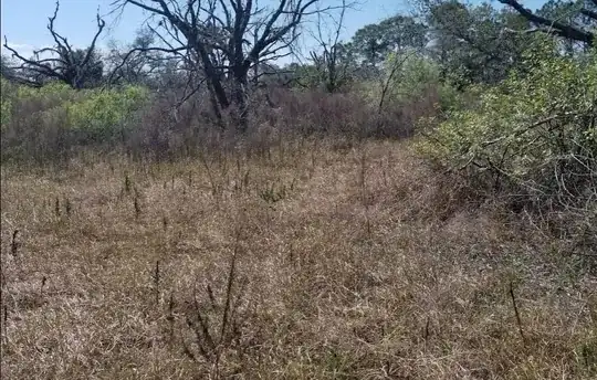

Anything distinctive in the grass or soil indicate flooding?
Do any of these images indicate rain run off flooding? Right now being winter in Central Florida and everything looks dry and brown like this.

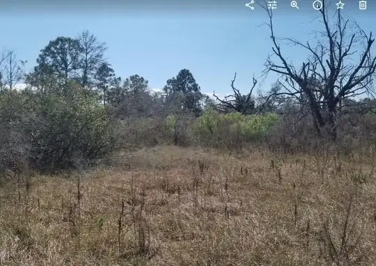

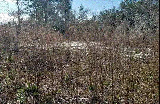

UPDATE 4/20/2020: Something like this?

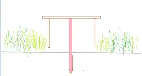

You could make indicators, e.g. stakes with a water-soluble dye (food coloring? water-color marker?) at various levels, covered by a plastic tube, and with a cone over the top, leaving some air-space between cone and tube. Direct rain should not be able to hit the stake, but standing water would rise in the tube, blurring the dye marks.
These indicators would be very inexpensive and easy to make, so set out a fair number in different locations.

The fourth picture looks like the initial growth after a flood event. Not certain. Check the species (on the gardening SE), if it is a swamp/wetland plant then it may be growing to indicate the edge of the standing water (plants start growing in the shallow water). The line of young trees may approximately follow the contour line. Look at known flood sites to see the same pattern.
Also, if flooding with still water there may be a very thin layer of silt that would not occur otherwise, difficult to check years later.
Possibly, a surface soil scraping left in a covered bowl of shallow water will hatch the invertebrates (mosquitoes etc) - then check if they are water species.
Lastly, investigate the topology around the site (up and down hill) looking for the temporary streambeds where runoff flows. These are easier to identify even a year or two after flooding.
