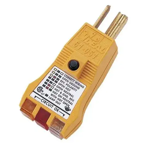

I would get a circuit tester like this to insure the adapter is actually safe.
