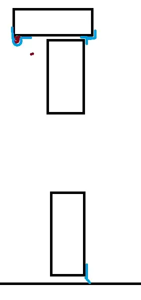

If you have any kind of wide tape that can be applied like the blue lines suggest, that may help you. The door will to be free of dirt or dust so the tape will really stick good.
The one example on the corner with the brown and blue is the example I meant in the comment. The 2 other examples are tape stuck in place and folded back so it sticks to itself and the jamb again.
