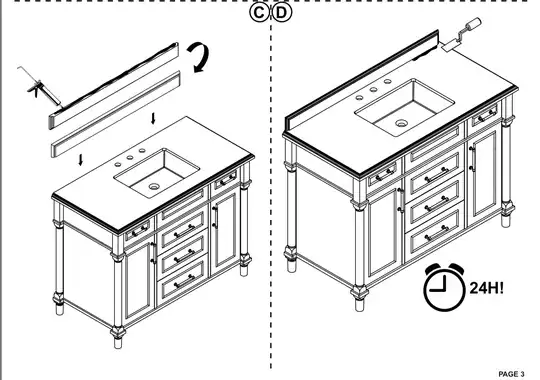

Here's the relevant bit of the "installation guide". There is no text...
excerpt from unhelpful installation manual

Clear, slow (ie, not 5 minute set time) epoxy is what I'd use. Apply masking tape on the countertop exactly at the seam line. Same for the backsplash. Glue and set the backsplash (clamp gently in place), and wipe the joint clean of the excess. (Disposable gloves will be your friend, here, as epoxy is hard to clean.) Pull the tape and wipe the joint one more time. Have whatever recommended solvent on hand for cleanup in case you get any epoxy where it shouldn't be.
My gut feeling is that this sort of setup is usually used against a wall, so they aren't expecting the backsplash to take a lot of abuse. Since you aren't against a wall, be careful in the future.
I don't think there's a need to rough up the mating surfaces, but it can't hurt.
And since you have a perfectly waterproof joint, I wouldn't bother with caulk.

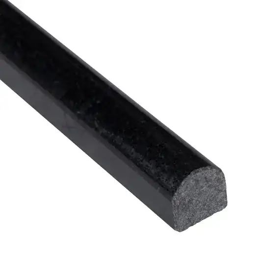

Instead add molding
An alternative and there are several different types of trim based on the look you want is to install a matching granite trim piece. An example below is granite pencil molding. You could simply apply clear silicone to install this. It will look better, function better, not be a hazard and if it ever does come off it won't take the other granite with it.
