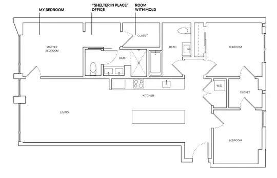

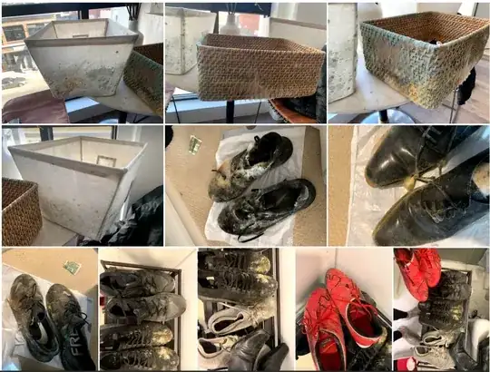

Over the last few days, other residents have been complaining about mold in the same position as my closet in the multi-story building. I decided to check my closet, and found a load of mold along the exterior of the wall. Some areas area more localized, where it follows the wall. In other areas, it's covered the items of clothing, such as my shoes.

Building description. 9 levels with 8 floors of condominiums, 4 to 6 on each floor. I am on the 4th floor. Some parts of the exterior are concrete.
New learnings: The room where this occurred is on the exterior of the building, where the exterior wall is concrete. I have since found out that the same unit in 3 floors above me and 1 unit below me have found mold in the same area of their units.

Current state: The cleaner who was sent by the building company removed all the visible mold from my unit, though they only wiped it off surfaces, and didn't check under the carpet etc. The carpet in that area is still damp. I put a dehumidifier and an air purifier in there, though the dehumidifier is pulling up about the same amount of water each day.

Floor plan showing mold
Examples of the mold I found in the room
