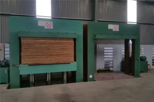

This might give you an appreciation for the difference:
Below is a basic old fashioned plywood press machine, the kind that has been in use since plywood was invented. Stack a bunch of layers of veneer on top of each other, some with glue between them, ever so often no glue, which differentiates the individual sheets. Then you press them together with a 400 ton hydraulic press and wait for the glue to set. You know an AVERAGE amount of time it takes under pressure, but to make SURE, you add more time just in case. enter image description here

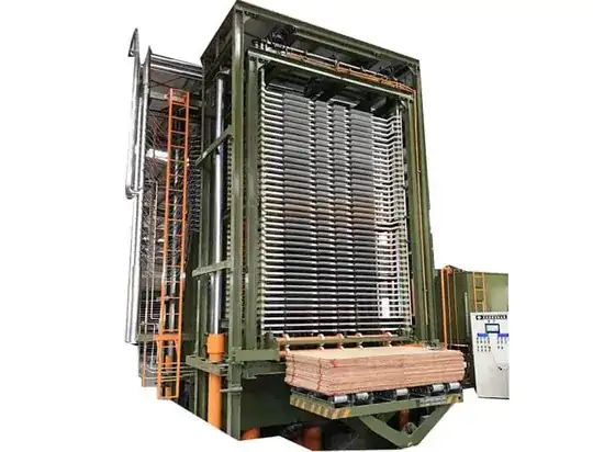

In a more modern system, the glued and unglued veneer sheets are fed in between plates of steel before being pressed by the hydraulic rams. enter image description here
Those plates have small tubes carrying steam though them to heat the product as it is being pressed and buried in those plates are RTDs, Resistance Thermal Detectors, that tell the computer exactly how hot the plywood got. This way the computer KNOWS when the glue is set, so it eliminates the guess work and cuts the cycle time to make each batch. It's a more expensive process, but results in a more consistent product quality and a higher production volume, resulting in more economies of scale and thereby, lower costs.
