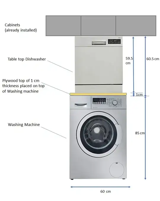

I have limited space because all the cabinets were already setup long back. A Bosch front load washing machine (60cm (d) x 60cm (b) x 85 cm (h) is placed in this space. There is a gap of 60.5 cm from the top of the washing machine free as of now.
Can a portable countertop / tabletop dishwasher (http://levant.beko.com/dishwashers/dtc36810w/) of dimensions 59.5cm (h) x 55cm (b) x 50cm(d) be stacked on top of the front load washing machine? What's the best way to go about it and any precautionary measures needed?

As there is limited clearance and only 1 cm gap left considering both the appliances height, am planning to place a plywood top of 10 mm thickness and size 60 mm by 60 mm on top of the washing machine with an anti slip map. Is this a feasible option or some other material will work? Will the washing machine be able to take the weight and handle any vibrations the countertop dishwasher may have?
Image of what i am planning: Plan

I don't see any reason why it could not be done. Of course you'll need to solve the problem of how to keep the DW in place on top of the washer. Most DW feet that I have seen are expecting to sit on the floor and they may not hit a good spot on top of the washer.
One thing that comes to mind is cutting a sheet of plywood that you can mount on top of the washer that has indents bored in the locations for the DW feet to sit it.
Note also that you'll need to secure the DW so that it doesn't fall over toward you. Usually they are unbalanced when the door is open and the mounting under the counter top is what keep them in place. You'll need to hold it down from the back or the bottom somehow, perhaps with some straps.

This seems like a terrible idea.
So to do this you will need to...
  • build a very solid shelf to sit the dishwasher on.
  • you probably need to buy a regular (not portable dishwasher). The portable ones are a lot heavier so they don't tip. You don't need that weight up there.
  • you will actually need to build a box for the dishwasher. You need a top to keep it from tipping. You need brackets to keep it from inching forward.
  • The plumbing will be a little tricky with dishwasher on top as you want the disposal line going up a bit before going down.
Even if done properly and building a super enclosed shelf, you have a huge injury risk waiting to happen. Shorter people and kids trying to get stuff out of the top - note that they door has to be open to roll out the racks... They fall or whatever onto the door, does the shelf/box support it? How is this super heavy dishwasher (dishes + water + its weight) effect the shelf over time. How does the washing machine which induces movement effect this shelf/box? Can this be done? Sure anything can be done. But this sounds like the beginning of a Darwin award story.
If you have limited cabinet space but have the ability to stack these then why not just take a cabinet out that is next to the washer and put it on top of the washer. This would probably be much more functional and more convenient.
