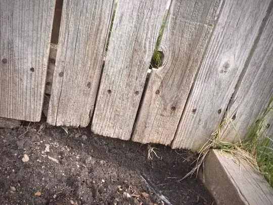

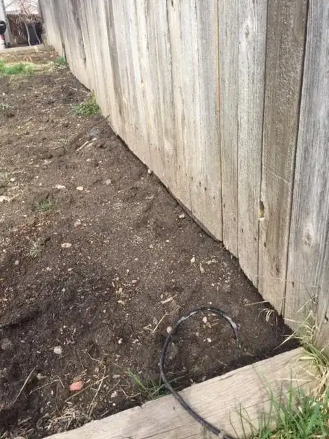

Our neighbors yard is elevated and they water their yard a lot. The water flows over into our vegetable garden and floods it. I would like to add a barrier. Some ideas have been slim pavers with a plastic sheet, or a tree root guard. I looked at grass barriers but they are only 5-6 inches wide - this will need to be at least 12 inches to go into the soil and be tall enough to stop the water flowing in. What could I use as a good barrier?

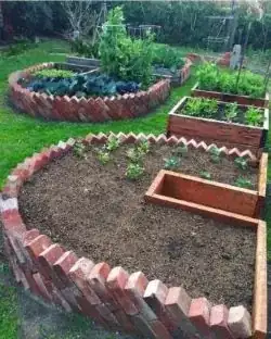

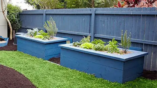

also you could turn that area into a beautiful raised garden bed higher again than the neighbours no problem enter image description here
enter image description here and if you wanted you could even put a small long thin sligtly buried water catcher -- then yah free water for gardening... hope this helps your problem

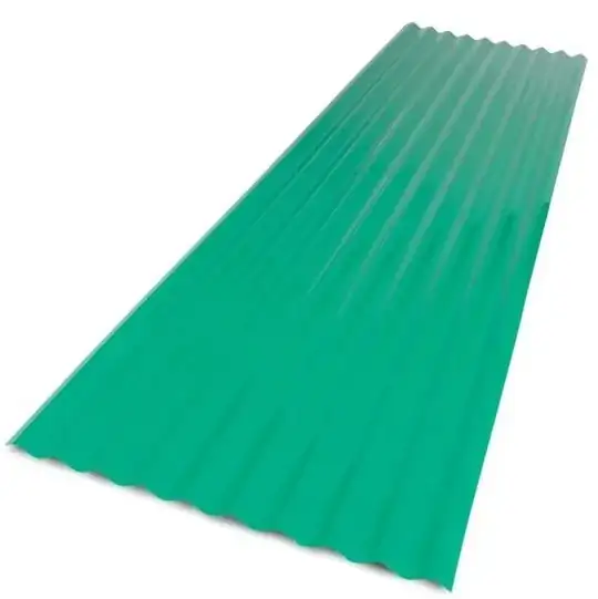

These PVC Panels from a BigBox store are inexpensive and could be used as a water barrier. Cut them cross-wise to 12 inches or to the depth that you need to bury them. Overlap them by a couple of "grooves" in the proper direction so that water will flow over from one to the next (instead of in-between them). You can also use some silicone caulk if necessary to hold the edges together.
pvc-panel
