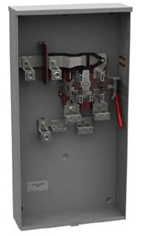

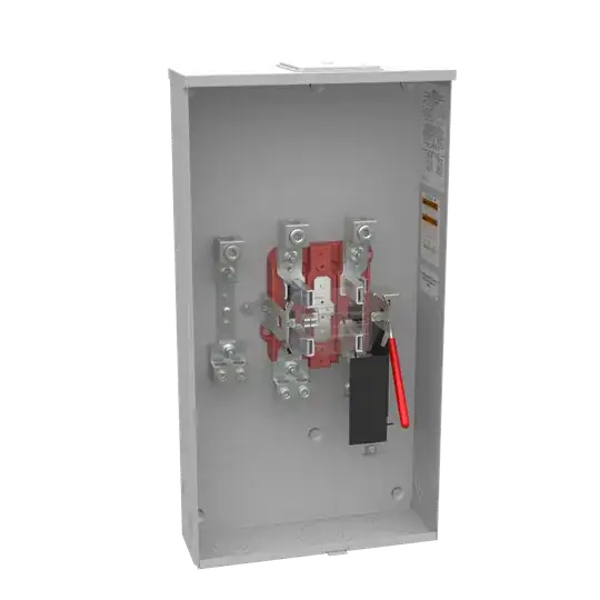

In my neck of the woods (Pacific NW) we call that a "class 320" service: A single meter feeding 2 main panels. Because both panels are considered main panels, neutral and ground need to be bonded together. In the meter panel, in most cases, the neutral is already bonded to the can just by how the lugs are attached. I recently installed a class 320 service on my son's house that did have a "service bypass" that would enable the power company to swap a meter without interrupting service, but I don't think that is what you have. A pic would help.
2020 code is requiring the ability to cut off power to a structure externally. That may have been required locally for some reason back in 2014...local codes vary. class 320 meter base with service bypass

The lever on the inside is a bypass
The lever on the inside of your meter can that you saw when the power company was working is what's known as a bypass lever that lets the power company take the meter out of circuit for service or replacement without interrupting the flow of power, which would be problematic for both you (power outage) and the utility worker (arc flash hazards). Most utilities require some form of safety bypass, either a lever bypass for utilities that use ringless metering such as KCP&L/Evergy or a test block bypass for utilities that use ring style metering such as PG&E, on class 320 services due to the higher energy levels involved.
