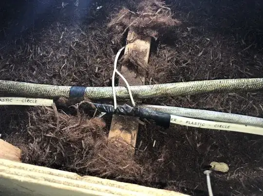

I found this junction in my attic when doing some unrelated work. It was entirely wrapped in electrical tape before I took the photos. My assumption is that it’s not code since it’s not in a box, but how dangerous is this? They split the wire and spliced the hot and neutral, potentially soldered to then new line, but left the ground intact. I took it apart and put it in a box. Is it worth looking for other DIY electrical?

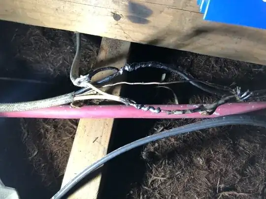

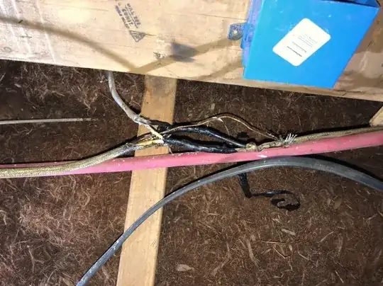

EDIT: Found another one! It seems even worse. Unfortunately I can’t even tell what this powers. It runs to an area that is difficult to access. Should I just disconnect it and see what loses power? It strikes me as a poor choice of wire to power outlets, to say the least, but I don’t know what else it could be. It seems to be a cheap extension cord which was spliced.

The junction is not to code because it would need to be made in a box. The wire is wrapped for a mechanical connection but I was taught 7 turns for a tap with old knob and tube, and without even counting we can see the insulation is burned. this happens when there is a poor connection.
The best option would be to purchase two construction boxes boxes and blank covers and a couple of feet of the same gauge wire. And 6 wire nuts and last some electrical staples 5 will be needed (the wire looks like 14 gauge). If you cannot read the size get 12 gauge. Or take a chunk to the store to match the size--bigger is ok.
  1. With the power off, cut the cloth braid wire to the right of the splice in the photo route the cable into the box. You need 6” of wire and the covering needs to enter the box--1/4” beyond the clamp staple that cable to the wood you mounted the box on.
  2. Run your new piece of wire into the box same thing 6” minimum and the covering needs to extend 1/4” inside minimum staple that wire.
  3. Mount your second box to the left where the two original cables can enter with 6” just like the others. Staple each wire separately unless you got staples rated for two cables.
  4. Bring the new wire to the second box and staple within 8” (note on boxes that do not have screw clamps or clamps that lock the wire in place, 8” from the box is code; if the clamps hold the wire from moving the staple can be 12” from the box).
  5. Strip the wires and use wire nuts to combine the 2 whites, 2 blacks and the 2 grounds. Twist the wire nuts until the wire has 2 twists. Do the same for the 3 wires in the other box install the blank covers and you are done.
This really should be done right away. (Is that burned spot on the wood from the bad splice on the white wire?) You don’t want a fire and this would be the least expensive way to make a proper repair.

Yes, this is very bad Bangkok-tier work, just hack-n-slash it in.
Here are the rules with boxes:
  • Every splice must happen inside a junction box.
  • The cable sheath must come into the junction box at least 1/4" past the cable clamp.
  • The individual wires must be 6" long past the point of entry (including sheath).
Now in a case like this, either fixing this mess or just properly tapping a thru-wire, you typically have 2 boxes about 18" apart. You strategically choose where to cut the wire so the necessary length will be inside the box when you are done. Then you add an additional stretch of cable (30"?) between the two boxes, again assuring it has the 6" length inside the box.
Do your splices first-rate, and you'll never have trouble. For novices, I recommend metal boxes; because if you accidentally do your splices not first-rate and they create heat, a plastic box will melt and drip molten box onto flammables. The steel box is a good heat conductor, and will effectively use the whole box as a heat radiator to reduce the chance of it reaching flammable levels. It's not a silver bullet, but it buys you time.
But yes. You generally expect Person X will do Person X style work throughout. Expect more of the same.
