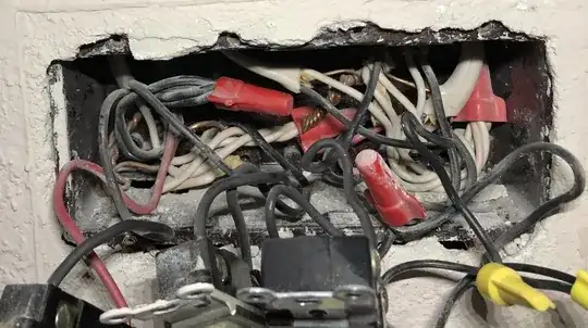

In my 1984 house, inside switch boxes, there are many instances where bare ground wires are twisted together without wire nuts. They are twisted really tightly about 4-5 turns.
It has almost certainly always been like this. The house was built by a reputable builder, who presumably used a proper electrician.
Is this per code?

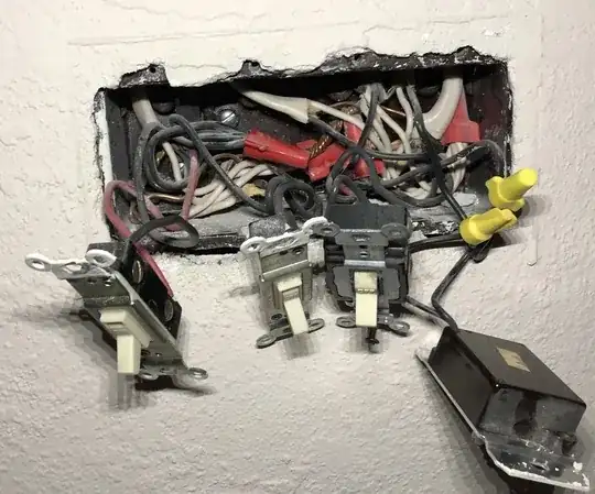

The previous owner replaced a few switches with dimmers (didn't connect the ground). I am now replacing some of the dimmers with LED rated dimmers. This box is non-conductive.
I plan on adding a ground wire to the existing twist and adding a big wire nut. There are four 14 AWG wires in the twist, now there will be five.
Or, if that is too many for a wire nut, there is a second circuit in this 4-gang box. Can I use a ground from a different circuit? (only two wires in this twist)

It's not a legal method now to not use a Listed connector, I don't know if it was ever technically legal, but the the NW US that was common practice back in that era.
Wire connectors have specific combinations that are Listed for it's use, but the normal colors represent trade norms. A yellow would be too small, a red would be fine, a tan which is between the two is normally Listed for 5 #14's, but the 4 wires being pretwisted increases their diameter, and you will likely struggle to get it to work properly.
All grounds are suppose to be bonded together, a typical large blue wingnut is only listed for up to 6 #12's or #14's, often you will find more than that jammed in, but the proper method is to jumper two smaller connectors together, or use a push in connector with enough ports. Using a push in connected with previously twisted and bent wires sometimes proves challenging. It might be best to use a red on the existing bundle with a pigtail to the second smaller bunch, and add your new ground wire there.

There needs to be a connector there, tying all the ground wires together
Some electricians get into the lazy habit of simply twisting ground wires together and leaving them that way, with no wirenut, dead-end compression joint, or solder to hold them together. Unfortunately, this does not produce a solid electrical connection, as there are only a few actual contact points in the bundle with nothing to compress it together or fill the gaps, and thus may fail under an actual fault condition.
Furthermore, the installer that put this in apparently separated the ground wires out into two separate bundles. This violates NEC 250.148:
250.148 Continuity and Attachment of Equipment Grounding Conductors to Boxes. If circuit conductors are spliced within a box or terminated on equipment within or supported by a box, all equipment grounding conductor(s) associated with any of those circuit conductors shall be connected within the box or to the box with devices suitable for the use in accordance with 250.8 and 250.148(A) through (E).
As a result, this needs to be fixed. Thankfully, this isn't hard. Simply take an eight-port, push-in type wire connector, add your new grounding wire to it, and then untwist each equipment grounding wire from its existing bundle and push it into a hole on the connector. Once you're done, all the bare equipment grounding wires should be in the push-in connector, connected together.
