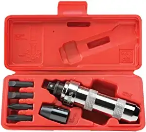

A Manual Impact Driver is designed to do exactly what you need...if you haven't already cut the head of the screws off.
They aren't expensive.
