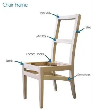

Picture of how my chair looks like
The chair looks something like this, and one of the joint at the back near the corner block has come loose (just above the arrow where Stretchers is written).
Is there some hope to get this fixed and in usable condition?
'Til now I have joined the back and the front legs with ropes, to create tension, so that it will hold and it is doing a decent job, but I am sure there will be a better way to repair it. Thanks.
Spread the joint apart and scrape off any excess,loose glue. Spread your wood glue over all the surfaces of the joint, in any dowel rod holes and around dowels. Make sure there's a groove in the dowel rod so excess glue can escape. Press the joint together firmly, tapping it with the hammer. Take your rope and wrap it around the seat frame of the chair and tie a knot leaving enough slack so you can loop the hammer or other object in the rope and twist it to tighten the rope around the frame, clamping the joint tight,like tightening a tourniquet. Let the glue dry 24 hours and you should be good to go.
