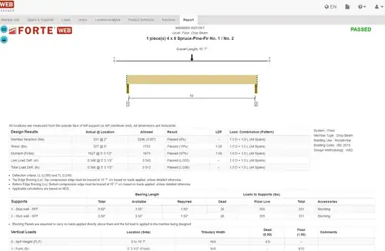

Forte Web is an excellent tool for designing wood beams.
That being said, it can take a point live load at mid-span of 610 pounds. Make sure you purchase #1 or select structural. You don't want any knots in the beam because of the types of forces a swing will apply to it.
