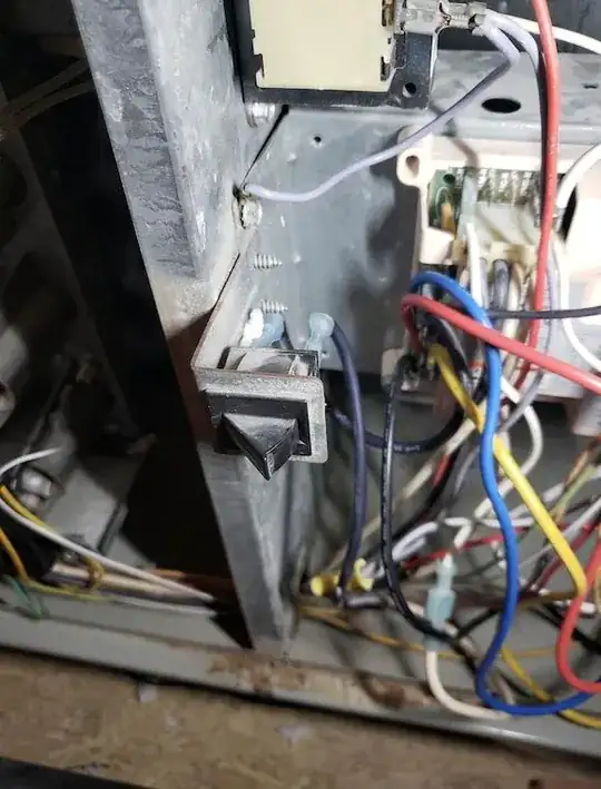

Anyone have any ideas? I'm incredibly concerned about why the outside of the blower housing would be electrified (Edit: On further reflection I'm not sure it was), but the motor did have a ground to the motor mount, which I reattached before attaching it to the blower.
There's no spark from the capacitor when I short it out before touching anything, so I'm wondering if it's charging correctly... but again, not sure what that would have to do with the power issues.
This is the power button I'm referring to: enter image description here

I don’t think that is a power switch. That is a safety switch that is depressed by the cabinet panels when you put everything back together. It should not work unless it is depressed. You should be good. Not sure how you got shocked though.
