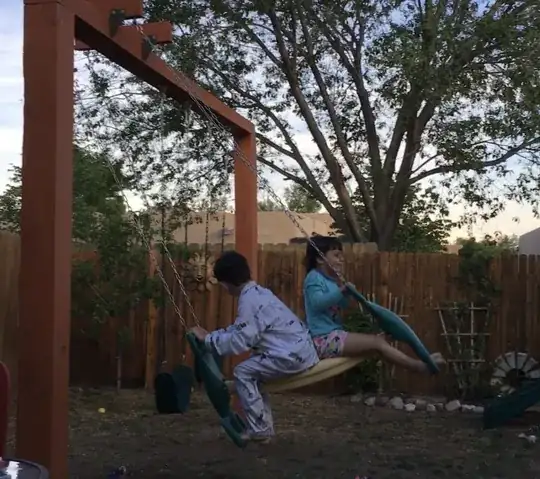

We've had one in our yard for 12 years. Ours is extra wide, large enough for 2 swings and a glider. It has held up perfectly and was rock solid until just this year, when it started to have a slight wobble. I'd refill the concrete footings, but my kids are old enough now to just remove it entirely.enter image description here
