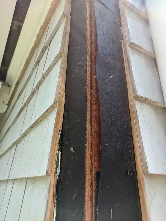

I have removed corner trim in one location to see what's underneath. Photos below.
  • There is some tar paper (I think that's what it is) under the shingles but it is open at the corner.

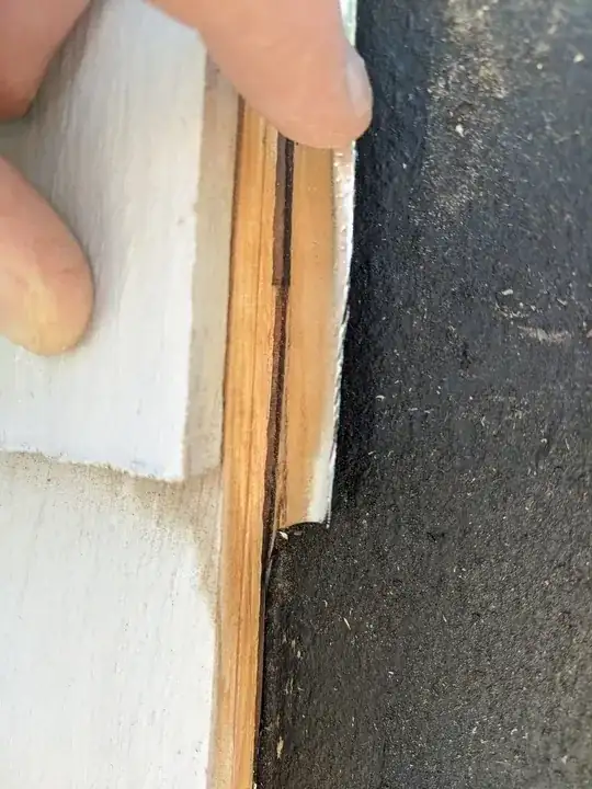

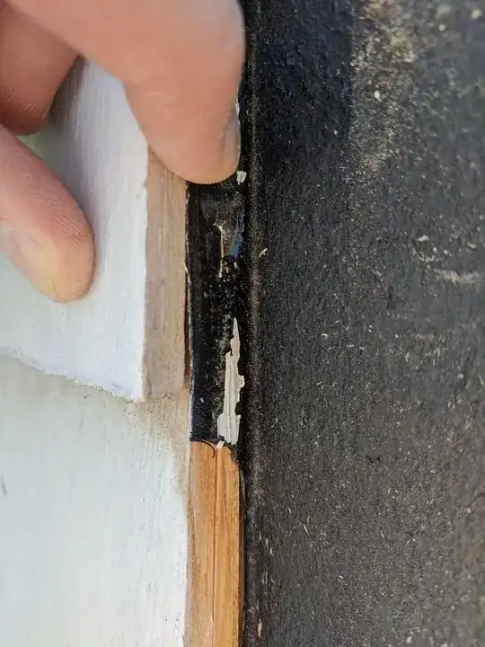

  • One one side, the cedar shingles appear to be installed atop some sort of foil housewrap
  • On the other side, there is no housewrap - shingles are just atop the tar paper
  • The corner trim pieces were just adjacent to the shingles - no sealant/caulking in between.
  • Where housewrap exists, it was kind of folded around the shingles and was between the shingles and trim.
One main concern is that water can get between the corner trim and the cedar shingles and could work its way behind the shingles...although it doesn't appear that this has happened, as I don't see signs of water damage underneath.

Image of corner: note housewrap under shingles on left side but not on right
close-up of housewrap, which extends less than an inch beyond shingles in a few places
this was position of housewrap between shingles and corner trim: foil side faced the edge of shingles, and backside faced the trim

Traditionally you'd have just caulked the siding to the corner board, and that would act as the drain plane. However, modern standards do tend to provide a secondary plan, as you've surmised.
You should be able to gently pry the siding out from the wall just enough to slide any flashing you like in there. Use a flatbar or a chisel, and align the tool as closely as possible to the siding nails. It might also work to drive wood shims in behind at those locations.
