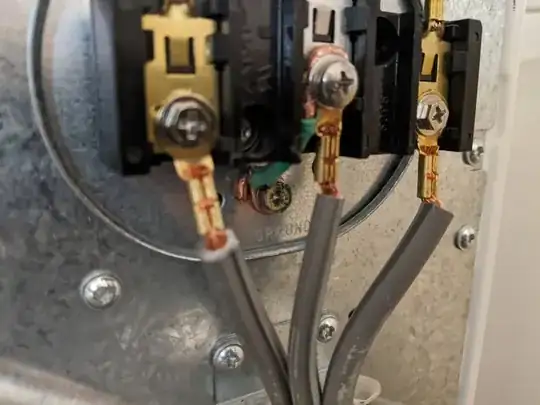

The ground strap that the documentation mentions is not present nor is it available. I have fashioned a connection from 10 gauge copper wire. The new installation looks like this:
Proposed 3-prong setup

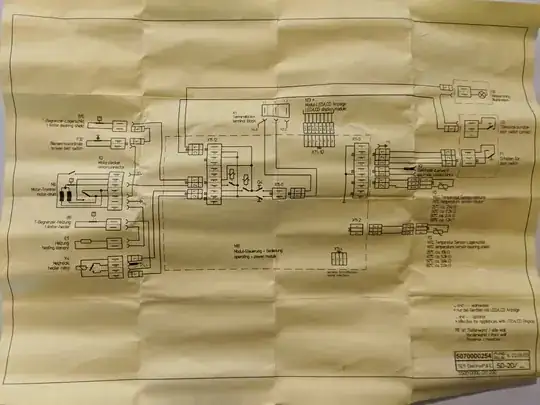

This is the wiring diagram for the dryer:
dryer wiring diagram

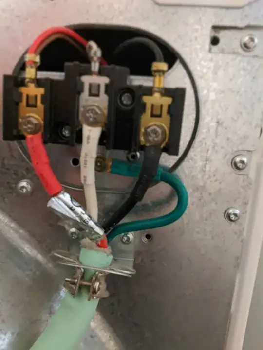

This is the original 4-prong configuration:

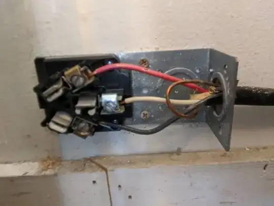

EDIT: This is the inside of the current dryer receptacle, which is connected to a THQL breaker in the junction box (picture of that in the comments):
Inside of current dryer receptacle

I think ThreePhaseEel is going to come in with a few ways to do that, but the first thing you can do is open up the 3-prong receptacle and see if there isn't really a ground wire (or metal conduit back to the panel) back there. Often, the ground is present, but the builder changed it to 3-prong because the buyer said they had a 3-prong dryer.

Just change the receptacle out
Since you have all four wires (black, red, white, bare) there, there's nothing stopping you from changing that bad old NEMA 10-30R out for a nice, safe NEMA 14-30R. You can then put the 4-prong cord back on the dryer, remove the field-fabricated replacement bonding strap, button things back up, turn the breaker on, plug the dryer in, and enjoy your dryer, without having to worry about an open neutral causing your dryer to zap you!

What you have done is correct but whether it is safe is another thing. If I had to do this at gunpoint, I would have used a Stranded piece of wire with eye connectors at each end. That would give a much more solid connection at both ends without a wire wrapped around a screw over a eye termination.
To test the connections with a multimeter I'd go from the middle terminal to each end terminal and look for 120V, then from the two end terminals and look for 240V.
