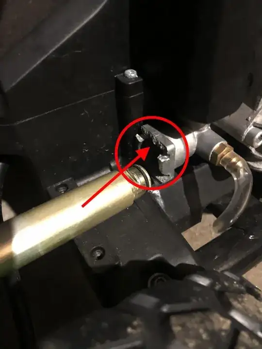

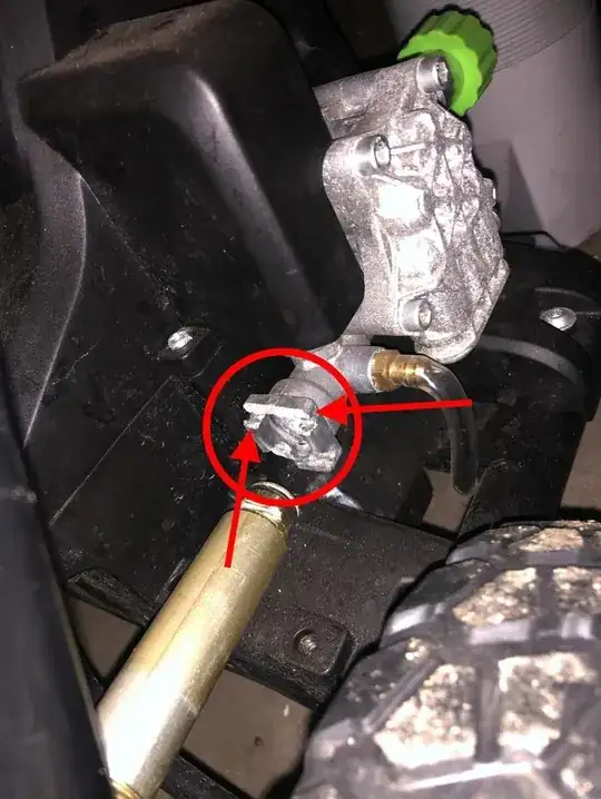

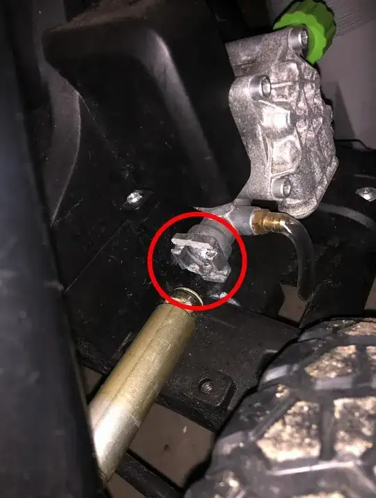

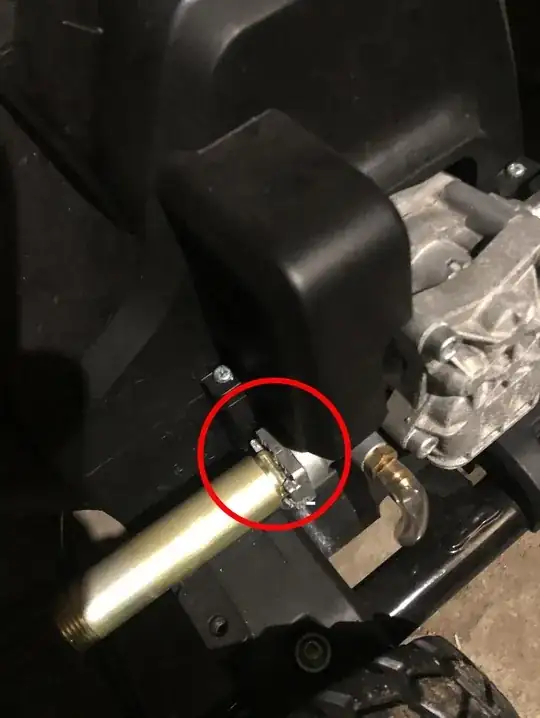

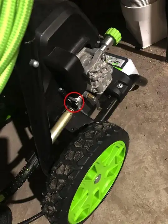

I have a pressure washer that I can no longer use because the area around where I attach my pressure washer hose is broken. I don't know much about pressure washers so I can't be any more helpful but I've attached some pictures of the area that is the issue. It is a Greenworks GPW 2000-1
What options do I have to fix something like this? Weld? Replace part? Epoxy?

There is a parts diagram and list near the back. It's somewhat difficult to tell from your photos vs. the diagram but it looks like the parts 20, 21, 22, 23 are involve here.
You will probably have to go to the dealer who sold you the unit and get them to order the parts.

@jwh20 answer was very helpful. After looking through the manual I was unable to pinpoint exactly what was wrong so I called the manufacturer. They advised me that the part that had to be replaced was the motor pump assembly and had sent me a replacement for $60 CAD (not USD!)
