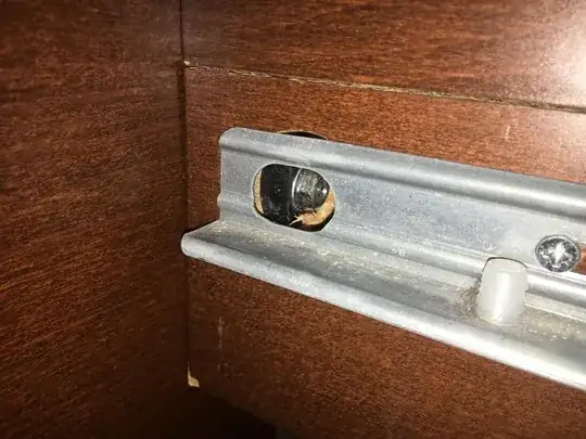

This is my first time posting in this forum but I wanted to get some help from y'all regarding removing a bolt from my bed frame. I bought a used bed frame and I need to dismantle it to shift it into my room. Here is an image of the bolt.
Could you please tell me what tools I would need to remove this screw (the silver nut on the left) as well as how I should go about doing it. Thank you, I really appreciate the help from this community :)enter image description here

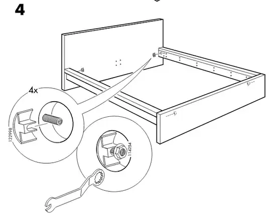

Looks like an IKEA bed to me - something like the MALM or the HEREFOSS.
You first remove the metal rail, then undo the nut. The manual depicts a wrench (ikea part 113453) but a regular metric 13mm wrench reportedly works fine. From the assembly instructions:
IKEA MALM bed image
mjt
  • 689
16
  1. Remove the metal rail.
  2. In the opening, you now have enough room to insert an open-end wrench.
The wrench has a slight angular offset. Push down on the wrench as far as it goes, remove it, flip it over, reinsert it into the hole and repeat ad nauseam.
Alternative: access the bolt head from another place.
