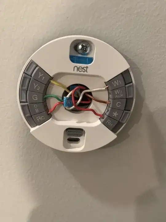

I've recently installed a nest learning thermostat (3rd gen). This is my wiring. wiring The c wire comes from the the transformer on the AC side (pairs with Rc). The system works and is able to call for both heat and cooling.

There is also a small, but non-zero chance that the base plate of your nest is defective, or one of the connector pins on it is busted, and the c wire energy isn't making it to the nest itself.
Check the nest app or the thermostat's advanced/installer interface itself to see if it is AWARE of the c-wire's presence. It should show you a photo of the wiring it detects.
If the nest thermostat itself (the piece that comes off the wall) does not detect the c-wire power, then it probably will "fall back" to stealing power from the other wires.
If both of your Nests have baseplates and you experience the same problem with both baseplates, then this is probably not the cause. My first thought when I started reading your post was the c-wire was broken. But you ruled that out with your voltage measurement. Good on ya!
