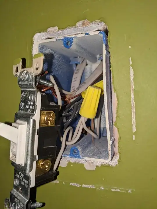

I'm just a programmer who wants to add an outlet below my light switch. I did a bunch of research on this topic and decided I could tackle it. According to my research, the hot/line is the black wire going into the bottom of the switch and the load is the top wire. The neutral is the white ones that are capped off.
But here I have white wires going into the switch and black ones capped off. Are the white wires line and load and the black ones neutral? Is this perhaps wired completely wrong in such a way that happens to work? How do I determine if this is wrong and how do I go about fixing it?
white wires wired to light switch

In a perfect world, black is hot and white is neutral. Unfortunately,that's not always true. I have seen houses wired opposite, against code. I've seen part of the house wired opposite. What you need to do is get a meter, not a wonder stick, and test your black group for voltage to ground. You should get 120v +-, then test white group to ground and you should get 0. If you get 0 when testing the black and 120V when testing white, then it's backwards and you or a pro should figure out why. It could be wired correctly and maybe whoever installed this switch decided to switch the neutral instead of the hot. Once you determine hot and neutral, you can think about installing your outlet.

I'm a residential electrician and thought I'd share.
You should use a tester to verify this, but the white bundle with 2 wires tied together in a wire nut and 1 coming out to your switch is the line side. The white that goes straight from the wall to your switch is your load, which goes straight up to your light.
You'd ideally just leave the switch side alone, jump one power out from your line bundle and one neutral out from your black bundle and attach them to the correct part of your new plug (and ground it obviously).
But, for reasons unknown, they used the opposite colors to wire your switch. I'd honestly just call an electrician to look at your panel and pop off some other switches and plugs to see if your whole house is that way or if they just made an oopise in that particular circuit.

Turn the light on and poke around with a non-contact voltage sensor.
The live wires side will show as live and the neutral wires as not live. make a note of which are which.
Turn the light switch off and check both sides of the switch. the one that changed between live and not live is the one that's going to the lamp, the other side is going back to the breaker
If the switch is on the neutral side it should removed be re-done on the live side
If the wire are the wrong color the correct color should be used, but fixing that may exceed your skill level. use the correct colours to connect your outlet to the supply.

It needs to be noted that a common wiring technique when wiring a switched light fixture is to run the feed from the panel into the light fixture, and then run a piece of 2-wire (plus ground) romex from the fixture to the switch. Since standard romex has one white and one black wire, wires of those two colors are connected to the switch, then, in the fixture box, one of the wires is tied to the black feed wire and the other is connected to the "hot" side of the light. This is the one case where code does not require that a white wire that can be "hot" (when the switch is on) be marked somehow (with paint or tape).
But the pictured box apparently has whites going to both sides of the switch, and there is no obvious tape or paint indicating that they are not neutral. In the US this is a fairly blatant and inexcusable code violation, and one should thus suspect that there are numerous other flaky things about the wiring.

Those are the colors that come in cable! Don't read anything more into it.
You see black and white because those are the colors that are built into all cable (except the cable with a third wire; that is red).
It's very common for novices to try to assign meanings to the colors. That is almost a lost cause. The only way colors have meanings is if you re-color them with colored tape. Otherwise, it doesn't tell you much. This much we know:
  • Green, yellow-green and bare are always Equipment Safety Ground. Fullstop.
  • White is first given to neutral, if that is not present it's given to always-hot, and if neither are present, then it's a dog's breakfast. Wow, that wasn't very helpful, was it?
Anyway, this job was done by a harpsichordist
When white is used for non-neutral, it's usually only 1 cable in the box, and very rarely 2 out of 3+ cables. When 3+ cables have all their whites in communication, that means White is actually neutral -- or at least, the same t hing.
Another law in the - well, almost everywhere - is that you switch the "hot" wire, so when the switch is off, the lamp is inert/safe. So normally, black (well, non-white) wires go to the switch. It was done backwards here! What exactly that means, we don't know. Either
  • In this switch box alone, the installer chose to switch the neutral wire, but white is still neutral and black is still hot. Or...
  • Harpsichordist theory: the person used white for hot (and black for neutral) throughout the circuit, renovation, or house.
Which one? That's what needs investigation. That's why ThreePhaseEel would like to peekaboo inside the panel - or at least confirm that white-to-ground is near 0 volts.
If everything else in the house is correct, then repairing this is a simple matter.
  • Note the solo white coming off the switch. Its partner black is supposed to be the switched-hot, so use red tape or shrink-tube to re-mark it red. (red is preferred for switched-hot; this is not a Code requirement but it makes wiring easier, especially for novices).
  • Remove the switch.
  • Re-mark the white pigtail black (mandatory to mark it something; black is preferred for always-hot).
  • The switch gets the black pigtail, and the red wire.
  • All neutrals go together.
  • All always-hots go together. (i.e. unmarked blacks and wires re-marked black).

In newer homes that use Romex wire the standard is 12 gauge with one black wire, one white wire and one bare wire. The colors are normally used as follows: black goes to hot, white goes to neutral, and bare goes to safety ground. 12 gauge wire is normally used to carry up to 20 amperes of current. 12 gauge wire is normally paired with 20 ampere circuit breakers.
In some cases 14 gauge wire is used to save costs and it is normally paired with 15 ampere circuit breakers. The wiring for a standard duplex power outlet has three connections. The hot side, that goes to the smaller slot and has a coppery color screw, the neutral side that goes to the wider slot, and normally has a silvery colored screw, and the safety ground which goes to the round slot which has a green colored screw.
When wiring a light switch it is normal to place the switch between the hot power coming from the breaker panel and the hot side of the light receptacle. It is also possible that the light receptacle and switch is wired to interrupt the neutral side of the light receptacle.
To determine what you have at the switch you will need to measure the voltage present at the switch connections and determine if the voltage remains hot no matter if the switch is on or off, on one of the connections. You must have a working light bulb present in the lighting socket for this measurement to be valid. Measuring should normally be done with the common (black) meter lead on the safety ground and the hot/active(red) meter lead on the connection being tested.
If that is true, that the voltage remains hot(120-130 volts AC) then that connection is hot from the breaker panel and can be used to power an outlet. One other thing to consider. Lighting circuits are often run with wire gauges that can carry less current as lights do not normally draw as much power as appliances plugged into duplex outlets. Using a higher number gauge, which is a thinner wire, saves money during construction but means it can only safely carry a lesser current.
I am not a licensed electrician. The electricians are licensed to know the local electrical codes where they work. Having practical knowledge does not mean wiring you do will be considered up to code or safe in the eyes of code enforcement. This can affect resale value of your home and more importantly, affect safety for your homes occupants. You will need to turn off the power to the switch you are wiring to.
You will need to verify which breaker powers that switch, unless you turn off the main breaker in which case an assistant with a flashlight is recommended. Even with the main breaker off, it is wise to verify there is no measurable voltage present on the hot wire you are tapping off of before you start your work. It is also wise to ensure no helpful but misguided family member is present who might decide to turn the breaker back on while you are working.

Ok guys it's AC, both are live. Neutral is the identified conductor. That means it's grounded thus the name neutral. With a test meter go from your bundle of blacks to ground. Does your meter show voltage? Then do the same with the white bundle. That will tell you if the colors are mix up. If the black side lights up your tester then the person that wire the switch incorrectly. All the connections in the house should be check.If you use the white as a switch loop, it has to be taped a different color.

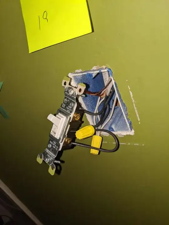

I thought it would be good for me to provide an answer to exactly what I did. For the sake of brevity, I'm not going to mention every time I turned off and on the power. Just infer that any time I would be manipulating the wires the power was off. Any time I was testing the wires with a multimeter, the power was on... and I was being extremely careful not to touch the wires or let the wires touch another wire of a different color.
First, I grabbed my tablet PC and drew out a diagram of the circuit. I used a voltage tester to determine that the top terminal in my original picture was hot. This told me one of two things. Either it was hot because the wire was the hot or it was hot because voltage was moving from the hot into the lights and then back down to the neutral.
Next I unscrewed the black bundle. If it also had a voltage then my first theory was correct, otherwise the white was certainly the hot. It turned out the black bundle also had a voltage. So the white indeed was neutral, the black was hot, and this switch was wired wrong. Given that I'm not a professional, I took other measurements to be sure by disconnecting wires from the switch and each other. My theory proved to be correct.
I then needed to determine which of the three bundles was my line, which one was the load going to the lights, and which one was a load going who knows where (likely another outlet). Using logic I determined that my original white wire with a voltage was likely the neutral coming from the load. The black wire in the same insulator was likely the wire going to the load. The black that had a voltage was my line and the third one was the load to who knows where.
I drew up my theory on my tablet and then wired it the correct way. I then tested it and everything worked. From there I could wire my new outlet.
Below is a picture of my "corrected" wiring. THANK YOU EVERYONE for helping an unskilled computer programmer work through this electrician work without zapping myself.
