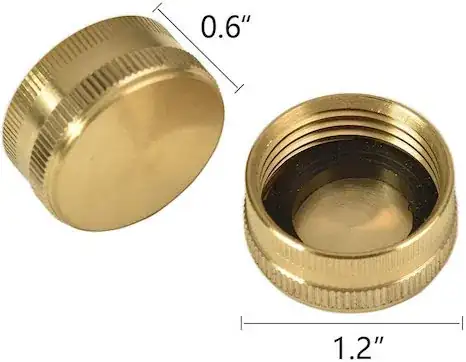

I have a water tap in the garden of the house. My little son keeps opening it regardless of how tight I close it. I would like to seal it off. I was hoping to find a metal cylinder shape element which I can screw on the tap water end. Any help would be highly appreciated.
Please note that I can't close the water supply to the tap.

You can get a hose cap and screw it on nice and tight.
You could also remove the handle if it has one screw in the middle.
You can also do a web search for "locking hose bib" and find a plethora of options.

Hose caps as mentioned above will definitely do the trick. You might think about just removing the spigot handle. They usually just have a screw in the center holding them to the valve stem.

  • Add a hose cap to the spigot
