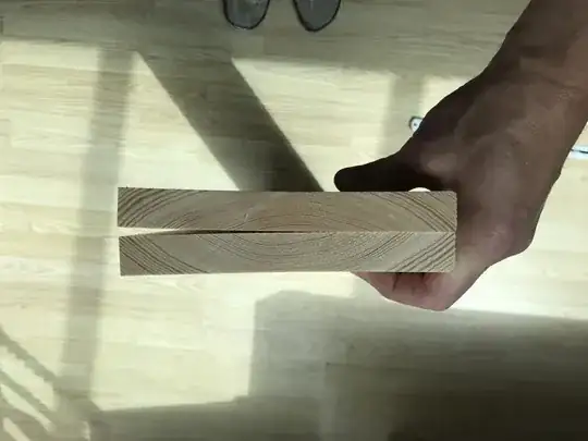

Recently I noticed warping across the width of some of my shelves. Attached shows a 20mm thick piece cut in half and compared with itself. I wouldn't have expected such a thick piece to be bent across such a narrow width.
I don't know if this is normal for softwood (this is Scots Pine) but clamping a bunch of sawn pieces together for 24 hours made some decent improvement.

The thickness of the board will have some impact on the amount of cupping you'll see, but you'll need to go significantly beyond 20mm (~3/4") before you'll notice a difference. Head back to the builder's merchant and look at a board like a 2x8" (~50x200mm) - you'll see that even along the 200mm dimension the boards will curve (put the board on the 50mm edge, with the 200mm dimension vertical, then sight along the board, you're likely to find some that curve up or down - this is called "crown" and it's necessary to put the crown up when using this lumber in a floor or ceiling).

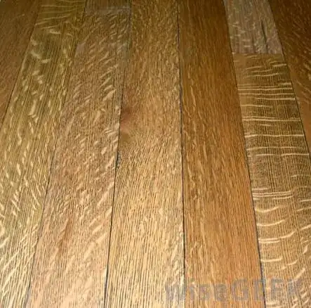

If you want to minimize the chances of your boards cupping, you need to purchase quarter sawn lumber. This will be significantly more expensive than the plainsawn lumber you show in your picture, and it will not guarantee that it won't cup on you, but it will significantly reduce the chances of cupping.
You can tell a quartersawn board by looking at the grain. The face grain will be very consistent along the length of the boards like this oak is:
Source: wiseGeek.com. No affiliation, just the first pic I found
You can also look a the end grain. Where the boards in your picture show the growth rings curving through the end, in a quartersawn board, they will run vertically (or near vertically) from one face to the other, like this:
Source: Bell Forest Products No affiliation, just the first end grain pic I found
