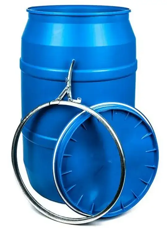

One option I have considered is using a 55 Gallon Plastic lidded drum as you can fit a hell of a lot of stuff in these and the lids come with Lever-Locked. The only downside to one of these barrels is the opening diameter which is 460mm and may be too small for more modern PC towers. 55 Gallon Plastic lidded drum (Source: https://www.bayteccontainers.com/oppldr55gal.html)

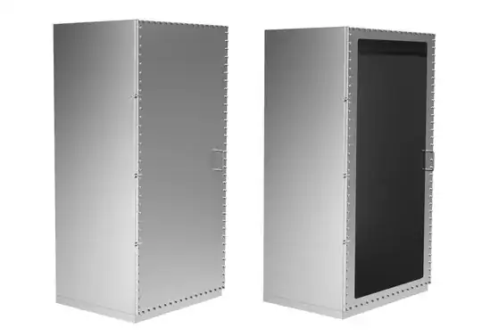

One other option I have considered is to use a submersible enclosure / Underwater Enclosure. These bad boys are designed especially for protecting electronic components, and come with a rubber gasket. The think to watch out for with these though is the rating.
For example this Freestand Submersible Cabinet Freestand Submersible Cabinet (source: https://slayson.com/product/freestand-submersible-enclosure-single-door-csmi-series/)
  • Is Submersible up to 15 ft / 5 mtr (IEC 60529)
  • Corrosion Resistant Salt Spray Test (ASTM B117)
  • High Impact & Crush Resistance (IK10)
But the rating is only NEMA 6P / IP68. NEMA 6 and 6P ratings allow objects to be completely submerged in liquids (water or oil). The numerical ending dictates the duration of exposure, with 6 referring to temporary submersion and 6P referring to occasional, prolonged submersion. It is important to consider that both NEMA 6 and 6P are not intended for continuous, long submersion. Lastly, NEMA 4 and 4X indicates a watertight enclosure. The “X” in 4X refers to a heightened level of corrosion resistance.
