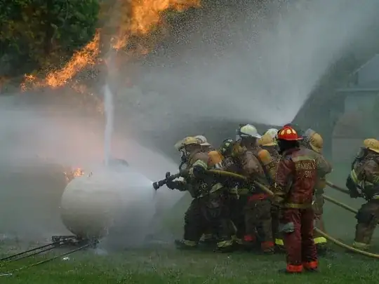

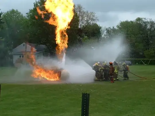

Update: In response to comments discounting risk of gas-related fires: Extinguishing Propane Fire More Extinguishing Propane Fire
Not something to take less than seriously (the hose aimed upward keeps the fireball from curling around and burning the firefighters from above and behind). The fire continues until the gas is shut off, despite the water.
The tank in the photo is probably the most common size for residential propane customers. Buried lines are likely big enough to eliminate any claims of a "small" fire... and how much damage will be done, even if the shutoff is not engulfed, in the time it would take to shut it off? Sure, there are always rare exceptions. Do you care to place a financial wager with me that has a 99% probability of your losing? Stakes are even higher here.
