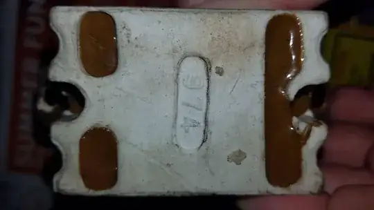

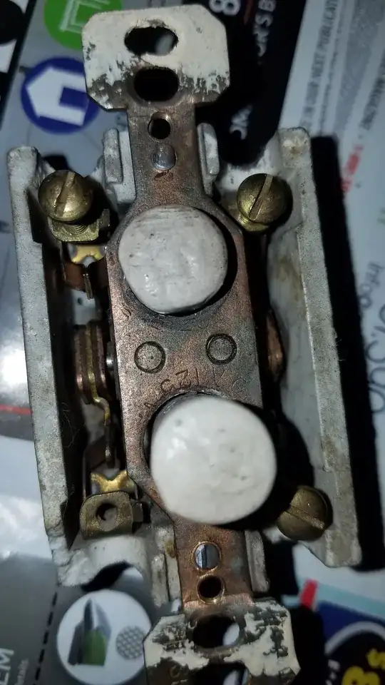

I have a circa 1920 push-button light switch which sticks occasionally. The push buttons move fine, but sometimes the blade switch inside doesn't flip unless the button is pressed very hard. I'd hate to replace this, because this antique switch has a more solid feel than replicas I've used. Is there a safe lubricant for mains power the switches?
And yes, I plan to remove the paint. :)
3-way push-button switch
Edit: I would take it apart to clean, but the screws have been sealed by some kind of resin.
3-way push-button switch back

And finally, you have a better course of action: Disassemble it and see where the moving parts have worn out. Some of these can be assembled with some part flipped and work 50 more years.

That material that's covering the screws can be removed by putting a drop of acetone on it and letting it sit for a few minutes. Then simply unscrew whatever you're trying to take off.
