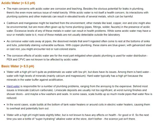

A couple of articles encourage the use of rainwater to flush toilets. (article 1, article 2)
However, would it be safe to do so if the rainwater in your particular area has a pH that is considered as acidic or akaline? (The risks of which are outlined on this page and reproduced below) enter image description here

It is doubtful the pH+ of rainwater anywhere, other than directly downwind of an erupting volcano, would be unsafe in terms of damaging plumbing fixtures or pipes.

  1. Acids: sulfuric or nitric, coming from the air pollution. If the air is more or less safe to breath, water raining from it is acceptable for the purpouse intended in regard to the acidic content. Steel pipes may suffer some corrosion, but they are rarely used today. Plastic pipes are OK.
  2. Bases: the only more or less gaseous base is ammonia. See about acids. Corrosion is less likely. You will pretty much know if there is unsafe level of ammonia in the air.
