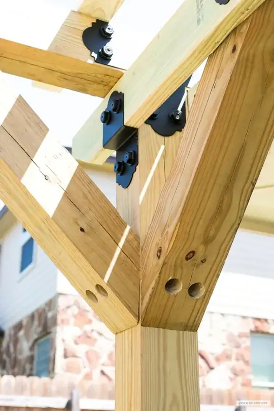

Here's a similar example courtesy of StrongTie. In this case the knee braces connect to the post at the same height, but I pictured yours being vertically offset (to match the height of the rafters). I would also deviate from this photo by running the bolts in horizontally. You'll need shorter bolts and I think you'll end up with a better connection.
