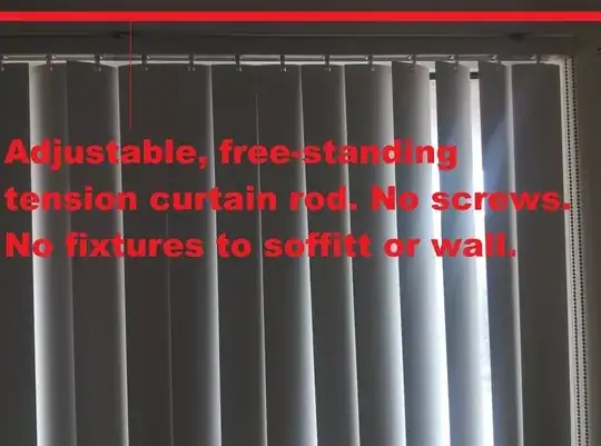

My husband is renting condo, and thanking you all, wants "install a proper rod on the soffit above". But his grouchy landlord prohibited "few screw holes" or "drywall spackle".
Will blackout curtain will be too heavy for curtain tension rod like this from The Bay? We're afraid curtain tension rod will keep falling. My math is bad. I don't know physics. Can someone pls calculate?
Blackout curtain weighs (I will edit this post after I weigh it).
Most likely, yes. I've used a few shower curtain rods of similar design on painted drywall, and they do fine. Blackout curtains are not lead-lined or anything. In fact, they don't weigh much more than standard fabric curtains in most cases. I have some in my bedroom now and they're quite light.
If you install the expandable rod carefully and don't expect it to hold the heaviest curtains out there, it should work fine. If you find that the rubber pads are slipping against the painted wall, consider something like removable double-sided foam tape between for extra friction.
Keep in mind that you'll punch a hole in unsupported drywall with these if you get careless. Investigate first using a studfinder or a few knuckle taps and install accordingly.
