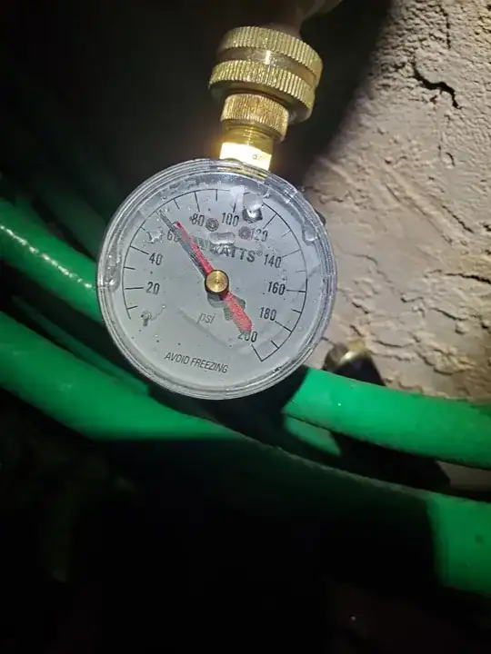

My house is in the hills; the water coming in from the city is 170psi. I have a Wilkins 600XL regulator that was installed about 10 years ago. Over the last year or so we have been getting high-pressure surges when a faucet is opened in the house. This lasts a few seconds and then calms down. I checked the pressure in a hose bib that comes off the regulator (about 20 feet away) with a Watts Test Gauge (with the twin needles) and it showed 120psi when placed on the bib (after releasing some water first). The red needle, though, capped out overnight at 160psi.
I bought the repair kit for the 600XL and installed all the new parts (all the old parts were very deteriorated). The pressure then read as 60psi but I was still getting faucet surges. The overnight reading was back at 160psi. I cranked down the regulator and now the “regular” reading is 40psi (and the pressure coming from the faucets seems pretty low), but we are still getting faucet surges and the overnight was again in the 160psi range.

So I thought I'd verify that the water heater is actually causing the pressure build-up when the water heats. I turned off the water heater last night (and ran the hot water in the house out until is was lukewarm). The gauge says the overnight pressure was 160in again, while the regular reading is 40psi.
There is a hose bib (for the garden) near the regulator that is not regulated, and that one reads consistently at 170psi.

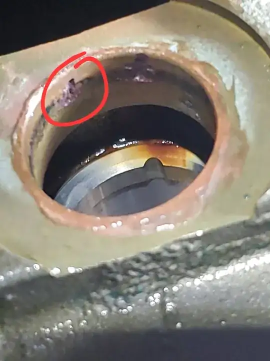

I also just rebuilt my Zurn Wilkins 600XL 1" pressure regulator, and it still is not controlling the pressure.
One thing I notice is if I measure the pressure immediately after closing a running faucet, I'll see the pressure slowly rising till it gets to abt 110psi (which I assume is city pressure levels).

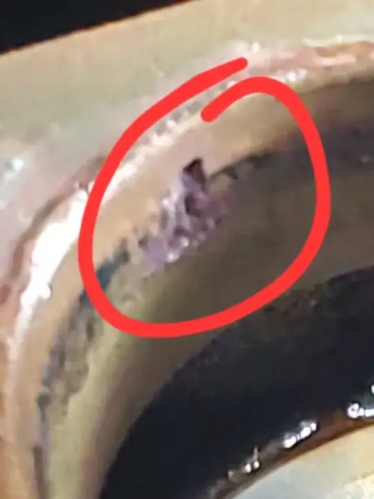

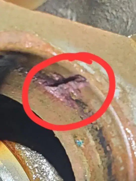

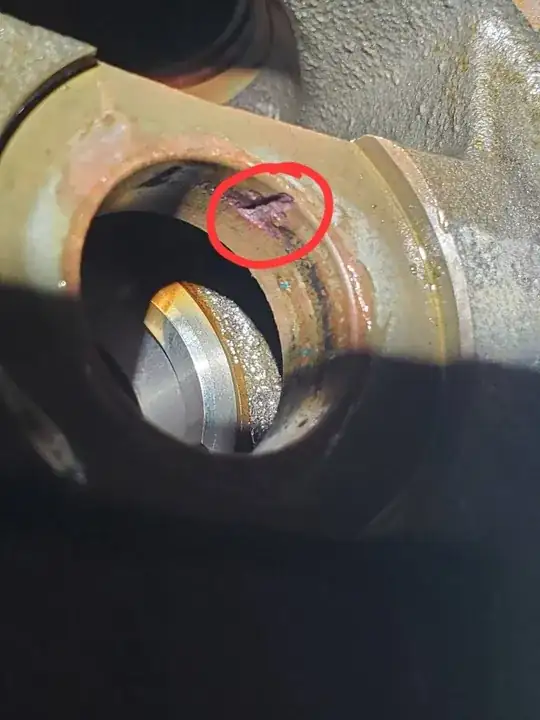

I pulled the valve apart again after re-installing, and I noticed two large chips in the bore where the stem unit sits. The chips straddle where the O-ring sits in the bore.
My theory is that those chips in the bore are allowing water to bypass the O-ring, and so not maintaining the water pressure.
This theory is inline with the behavior I saw where the pressure slowly increases when measuring immediately after closing a running faucet; a little bit of water slowly seeps through those chips raising the pressure in the house system till it reaches parity with the city pressure.
I can't explain how those two large chips got there in the bore, though.
I'll go to hardware store today and buy a whole new unit, and see if replacing the whole thing fixes the issue.
But maybe you have a similar issue that the core unit is bad...
UPDATE (about 7 hours later after my initial post)
I just got done replacing the entire PRV, and I'm now able to adjust the house pressure as expected.
