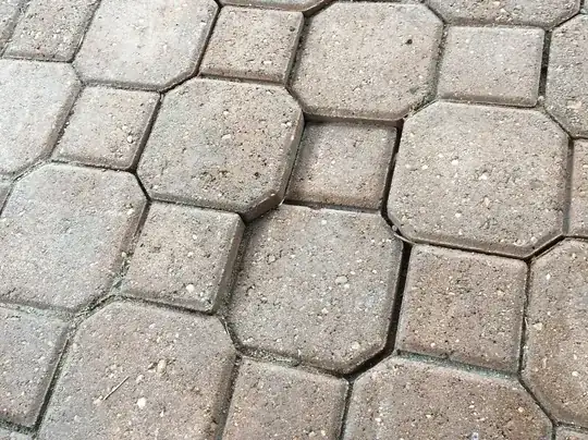

I have a couple pavers that have sunk in my driveway. If this was close to the edge, I’d take up a few, re-level and replace. But this is in the middle of a large expanse of pavers.
driveway pavers
How can I pull up a few in the middle to fix this without having to pull apart 1/2 my driveway?

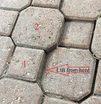

Using a crowbar or screwdriver etc. lift the pavers to the left of the sunken ones first. Lift the ones numbered 1 and 2 in the image:
Then you should have enough room to dig out the sunken ones.

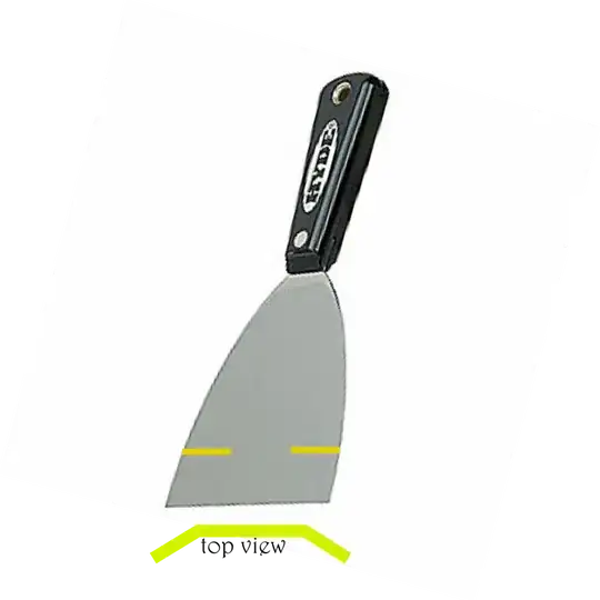

I've recently seen a video but can't find the link. Consider a Flexible Joint Knife, or the equivalent in a fairly wide spatula. Get a pair of them, to enable uniform lifting.
Slice from each edge of the spatula about one-third of the way inward, about an inch or two from the bottom. Bend those cut tabs in the same direction. As you force the tool into the crack, the tabs will be in the same plane as the crack, until you get below the level of the brick.
At that point, the tabs will extend under the paver providing lift points at four locations. Gently work the tool upward, lifting the paver a bit at a time.
joint knife mod

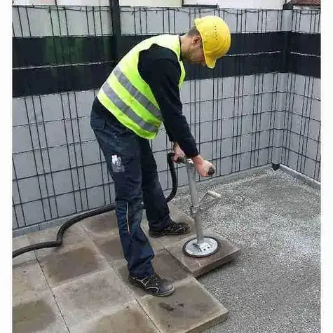

Just to add to the various hints, and complete the picture of available techniques, professionals who do this a lot would use a vacuum slab lifter, something like this:
Image from Express Tools
Source: Express Tools
However your surface area may be too small for this, but even smaller attachments are made for bespoke situations.
A bit much of a purchase for a one-off, but worthy of note for completeness sake!
