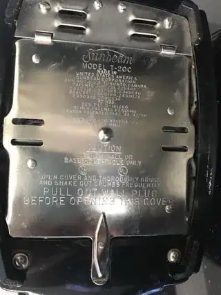

For some reason, I now own a Sunbeam Radiant Control toaster, model T-20C. While I found it in The Netherlands, it's fitted with a US cord and plug.
On the bottom, it reads:
VOLTS 110-120 WATTS 1275
FOR AC ONLY
The bottom plate of a Sunbeam model T-20C, relevant text transcribed above
I'd like to use it in The Netherlands, where we get 230V AC from our outlets.
Using a power converter is not an option, since the toaster wants 1275 Watts. And while power converters that can handle that power do exist, it's a bit overkill to get a slice of toast.
So is there any other option? The mechanism is simple enough, no electronics, just heating coils.
