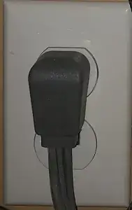

My house has the dishwasher and disposal plugged in under the sink, where the bottom outlet is hooked to the disposal switch. I've heard it isn't generally ideal to have both on the same outlet, but that's how the builders did it.
I just replaced the dishwasher, and the installation kit included a power cable with a right angle connection. Since the bottom outlet is on a switch, I have to use the top outlet, which blocks the bottom.
I realized this of course after I completed all the hookups and I really don't feel like taking the whole thing apart again.

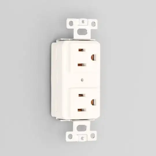

Although if you're going to re-wire your outlet, it's probably better to replace it with one that has the receptacles mounted at a 90-degree angle (example).
A buddy of mine had a sideways outlet like that under the sink and it was by far the cleanest way to connect a disposal and dishwasher that both had those right-angle cords. Also useful when installing an outlet horizontally in a baseboard. Mount it with the ground pin facing up and you can get enough clearance to plug in a bulky transformer without an extension cord.
