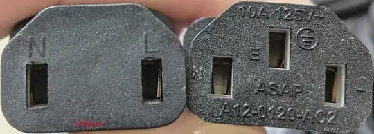

I have a Sony TV that has OEM cable on the left. I want to replace it with a longer cable on the right. The new cable fits into the TV's slot but would not have the third prong.
Is this safe to do? Does the third prong of the new cable interact in any way with the other two? What are these cables called?
left OEM cable, right new cable

The OEM cable does not have a ground or earth connection.
The cable on the right does.
So this will be a safe replacement for the original cable.
The ground connection will not be used and that wire in the cable is not connected to either of the other wires in that cable.

To answer the question of what these cables are called, they are IEC 60320 (commonly called kettle plugs) connectors. If you take a look at the "Appliance_couplers" section of the linked page you will see the left is c17/c18 (the male and female versions have different numbers) while the right is c13/14.
It looks like from the table the plug on the right is for class I appliances while the cable on the left is rated for class II appliances. In general electrical connectors are built with physical safeties such that they cannot be used in situations where their use would cause damage (this of course doesn't apply to hack-job scenarios like if the end-user were to grind out the safety tab to use a c13/14 connector when a c15/16 is required)
Selection of a coupler depends in part on the IEC appliance classes. The shape and dimensions of appliance inlets and connectors are coordinated so that a connector with lower current rating, temperature rating, or polarization cannot be inserted into an appliance inlet that requires higher ratings. (i.e. a Protection Class II connector cannot mate with a Class I inlet which requires an earth); whereas connecting a Class I to a Class II appliance inlet is possible because it creates no safety hazard.

Is this safe to do?
Yes.
The third pin is a protective earth connection, some appliances "class 1" require a protective earth connection to maintain single-fault safety. Others "class 2" do not.
The connectors are sensibly designed so you can use a cord with an earth for an appliance that does not need one, but not vice-versa.
The connectors are from the IEC 60320 series. The connector with an earth is a C13 while the one without it is C17. The corresponding inlets are C14 and C18 (normally the inlet has a number one higher than the corresponding cord connector).
Some of the more common connectors in the series have colloquial names, for example the C5/C6 is commonly referred to as "cloverleaf" or "mickey mouse", while the C7/C8 is commonly referred to as "figure 8". The C13 in my experience usually just gets referred to as an "IEC connector" or sometimes as a "kettle plug" (though this is ambiguous because actual kettles use the "hot condition" C15/C16). The 16A variants are usually referred to by their current rating "16A IEC connector".
I'm not aware of a colloquial name for the C17 connector though. In my experience it's a pretty rare connector. Most class 2 electronics are low enough power to use the "figure 8" connector and stuff like heaters tend to have fixed power cords.
I also suspect that the compatibility mentioned above means there is virtually no end-user market for C17 cords. Regular C13 cords are available everywhere and the economies of scale mean they are cheaper than C17 cords despite having higher material costs.
