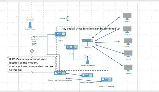

Picture below show devices described above and how they are integrated, managed, and linked at the central location. A single ethernet cable to each location back to the central location. Alternate path to these locations would be Wifi. Devices inside the dotted box is your central distribution center. Also additional Wifi access points can be connected from the central location to strategic location in the house for better coverage.
My recommendation for your “Distribution panel” is NOT a distribution panel, but a central distribution location with a minimum 16 ports switch that can also provide Power over Ethernet. Co-located with this switch, you can have the modem/router/Wifi access point, splitters, etc. This will make it easier to connect all the devices to each other and distribute the tv or ethernet signal to all the locations that have outlets or Wifi coverage.

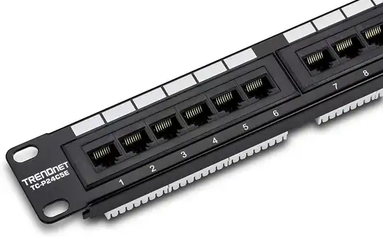

If you do go with a distribution patch panel, be aware that two types are being sold, EU-type that needs a Kron Tool for the punch down and the US-type that uses the 101 punch down. Even if you use the distribution panel, you will be patching all those runs to a switch, so why bother to wire up a patch panel, insert a patch cable for every location and connect to the switch. Patching panels are used in network termination rooms to easily “patch” a location/outlet to a different domain switch without having to reroute the cables.

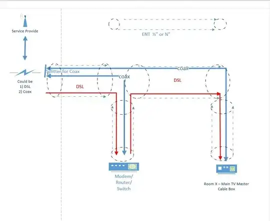

Adding additional information based on comments and questions.
½” ENT would be adequate but ¾” at a little extra cost would be my preference. Note in my drawing the ENT stops at the place the wires go down the stud. ENT is used in the stud space to the outlet box. This allows you to push/pull cables from the attic at that location and go off in a different direction. You do not have to provide the splitter for the coax. The proper splitter will be provided by your service provider. For the DSL cable, run Cat-6. I believe the diagram below is what you are trying to do.

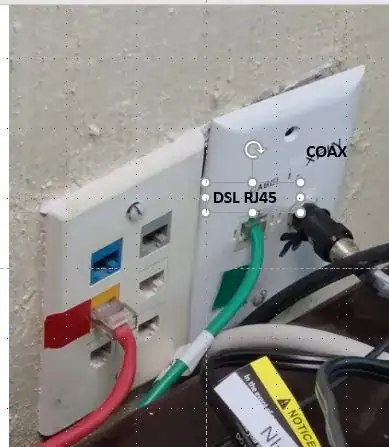

The picture below is what I believe you were originally trying to get an answer for. At various time and just recently, I had both Coax and DSL services. I wanted to make sure my new services and cable were working before terminating one of the services.
The Outlet box on the right has two slots, one for RJ45 (DSL) Service IN, and the other one is for coax Service In.
The panel on the left is for ethernet connections on the 2nd floor to a switch which distributes ethernet access to all the rooms upstairs. This was setup and configured before wifi.
