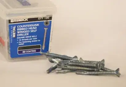

I did find a B8 coating from Bremick that is an electroplated zinc and nickel blend that is compatible with galvanized steel and may have enough corrosion resistance to be substituted for stainless 304 or 316.
B8 Electroplated Screws
I also found some bi-metal wing screws that have a hardened steel tip and a few threads welded onto a stainless head and shank, but it doesn't look like the hardened steel tip is intended to be load bearing and is just there to drill through the steel stud quickly.

After a bit of back-and-forth between the inspector, architect, and engineer, the conclusion is that:
  1. The B8 screws are acceptable since they are AS3566 Class 4+ corrosion level (ISO 9223 Category 5)
  2. Stainless steel grade 304 or 316 will also both work since the metal framing is formed from galvanized sheet and the stainless-to-steel connection will be inside the thermal envelope of the building. This metal combination is not permitted for the corrosion zone of the structure for timber framing standard NZS3604 (which assumes there is contact with moisture), but it is allowed for by the National Association of Steel Framed Housing (NASH) for metal framing formed from galvanized sheet (which assumes no permanent moisture contact).
