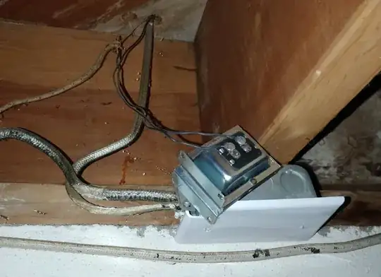

I bought a house recently. Some of the wiring, particularly in the basement, while not obviously unsafe, is... inspired.
On the side of a junction box in the basement, there's a device with two thin wires coming off of it, going up into a hole. I believe, but don't know for sure, that above the hole is an exterior wall, but there's nothing on that wall that would use such thin wires - just switches and outlets, which I'd hope are fed from the thicker cables also going through that hole.
So what is this thing?

Looks like a doorbell transformer. Prolly output is 24 V ac from input 120 V ac in the metal box.

I saw one of those things in my basement as well, and I can confirm that it is a doorbell transformer. If you want, you can get a multimeter and put the two leads on the two screws on the top. It should show a low amount of voltage ≈20-40VAC.
