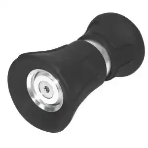

I rinsed using one of the "fireman" nozzles on my hose, just so I could get it up to the eaves:
nozzles
I did try just spraying the mildew with the nozzle...worthless. "Firemen" should sue for defamation.
